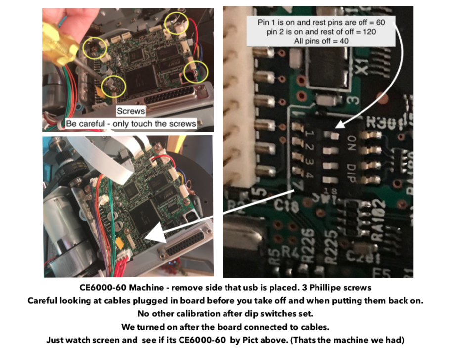

I discovered (with some experimentation) the super secret nintendo cheat code to get into service mode so I feel alot better about swapping the main board out. It's pretty simple and it will give you an adjustment option in the menu.

Here you go, any questions just let me know. Hope it works for you.
Did you input all of the values of the main board settings? They're on a sticker. You must do t his after you replace a main board. You should either get yourself a service manual, or hire a technician to do this for you.
