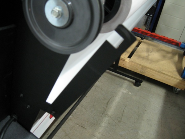

Yes Daige sent me the new roll lock kits and a new belt that is smaller and the QM4 runs flawless now.
spectracolor
yeah, i was going to say,all you need is a roll lock kit from daige and that should solve the problem. they send it to you for free upon request.
I was wondering why it wasn't just included in the box because it didn't look like expensive part...just a flat metal piece
and Yes, they work great for under 2000 dollars :)
B Snyder
For anyone that doesn't know what the "roll lock kit" is that PMG referred to here is a pic. This piece of metal keeps the shaft from popping out.
