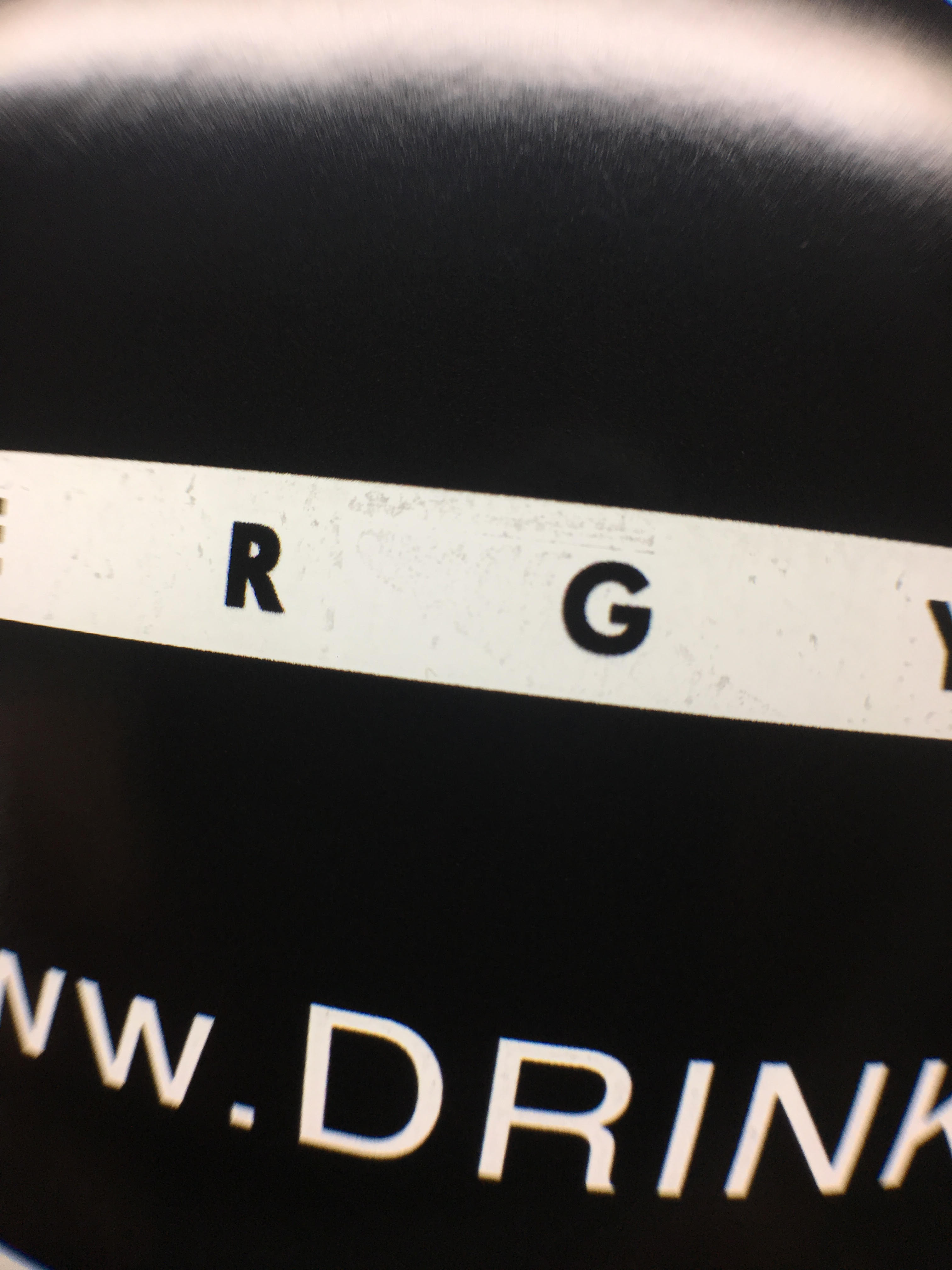

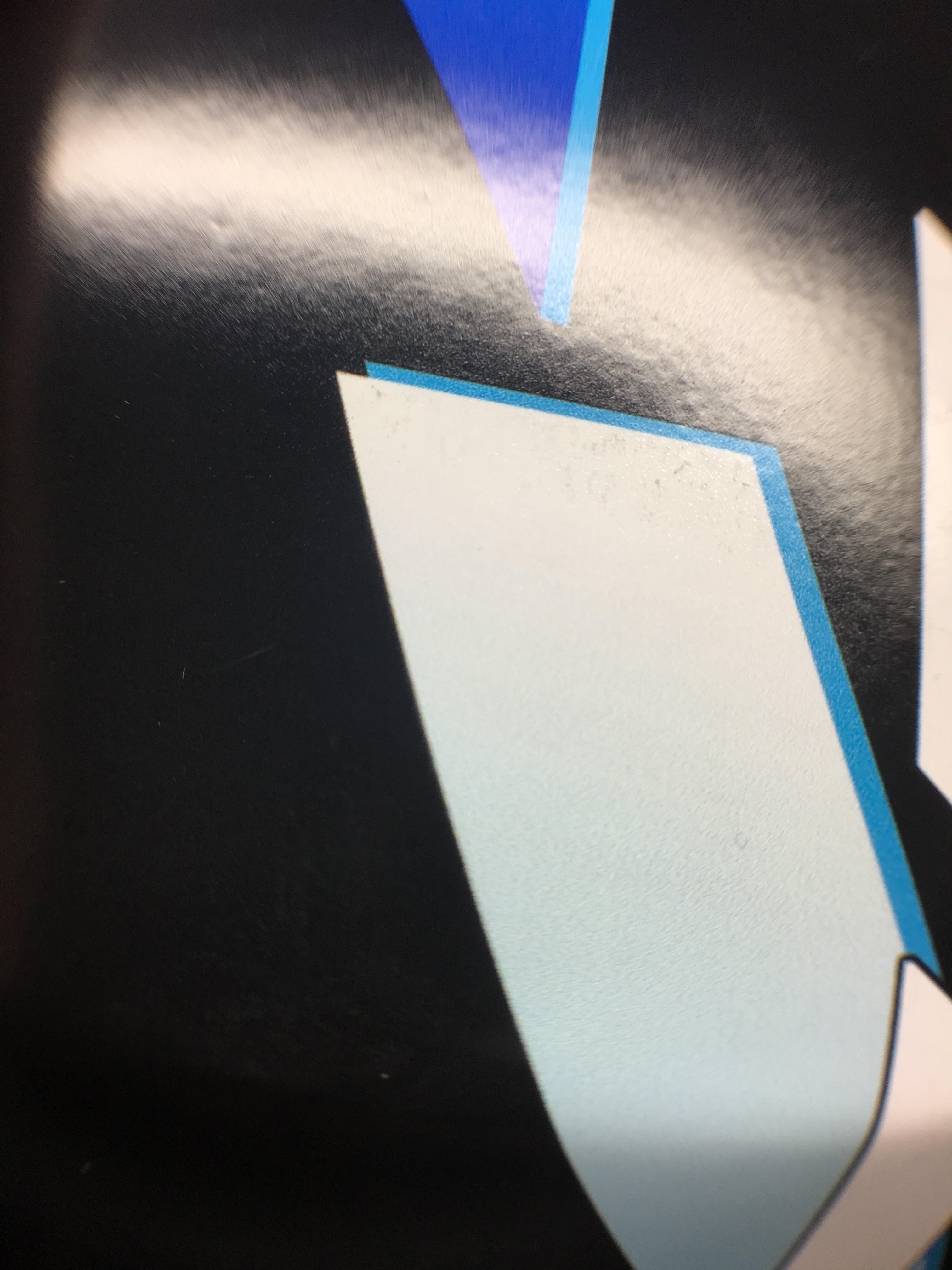

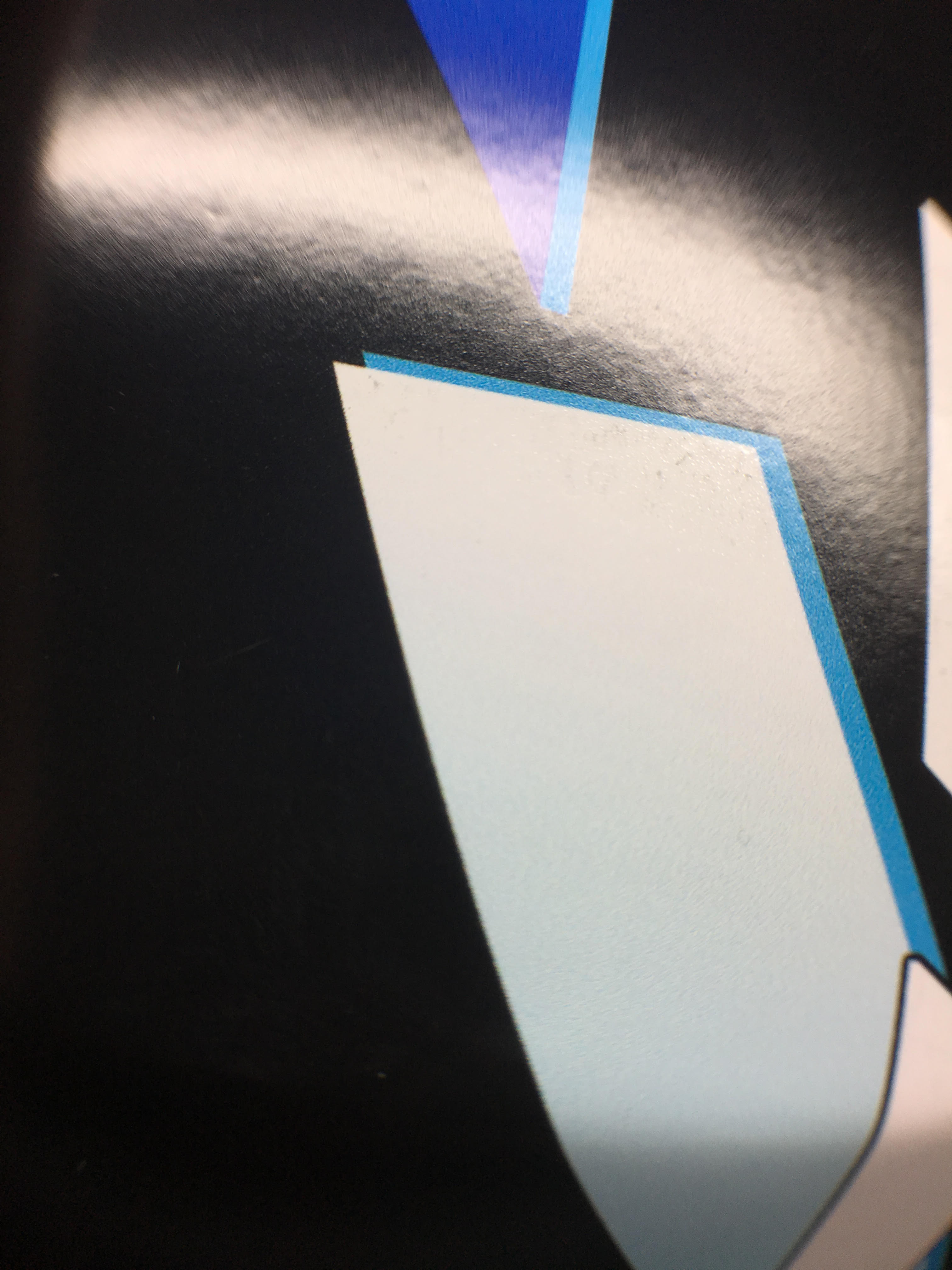

Here's an example of what we see. Full disclosure. I have zoomed in on the image and slightly adjusted the contrast so that the defect is more visible in the photograph. In person, the defects are visible from three feet or so away. I can't see how any client would find this acceptable.
