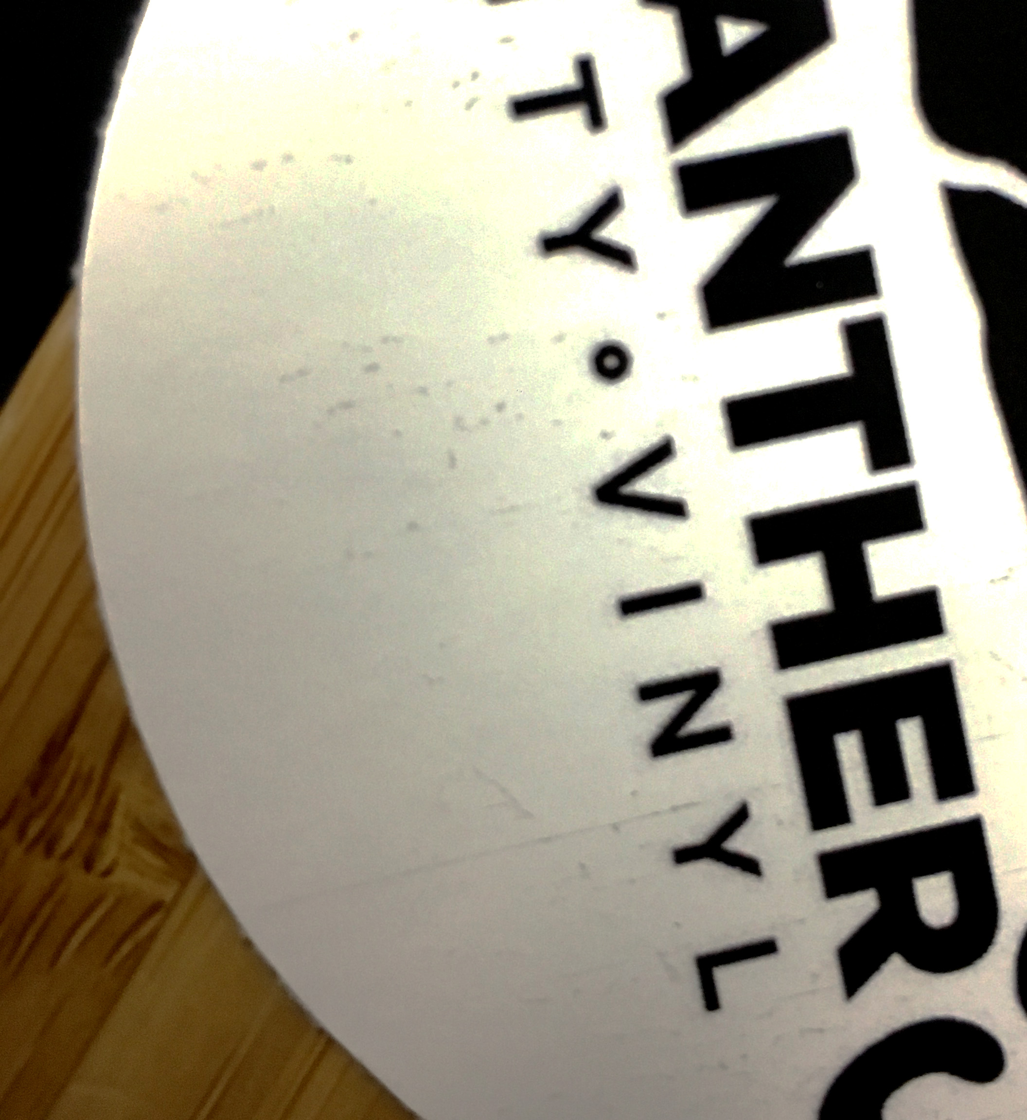

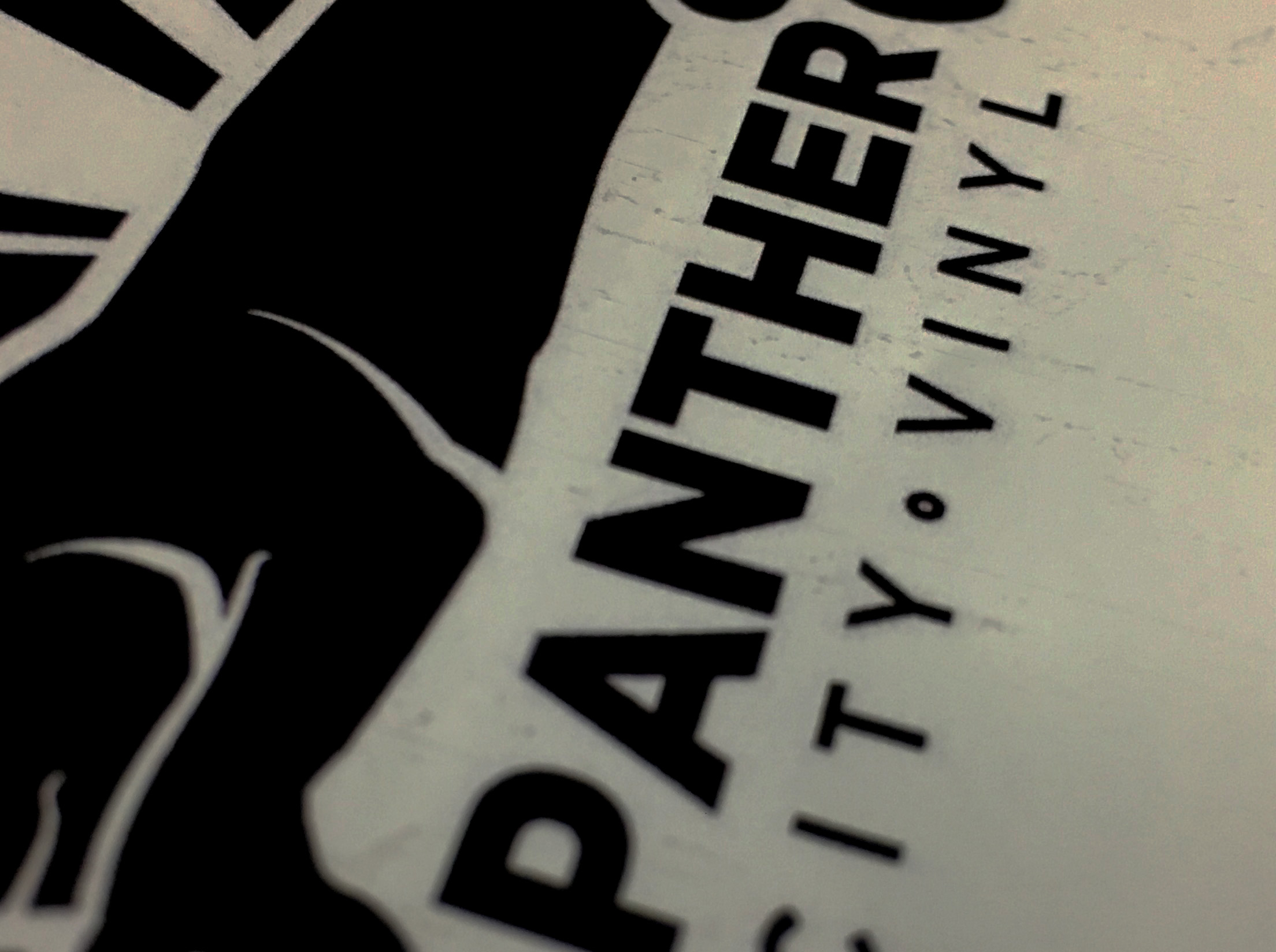

Here's an example of what we see. Full disclosure. I have zoomed in on the image and slightly adjusted the contrast so that the defect is more visible in the photograph. In person, the defects are visible from three feet or so away. I can't see how any client would find this acceptable.

What dealer did you buy it from? I would demand that they handle your printing until the machine they sold you works properly. We just finished up doing something similar with a client, we were able to produce work for them while our techs were trying to fix the equipment we had sold. It was only down for 3 days but the client never missed a beat.
