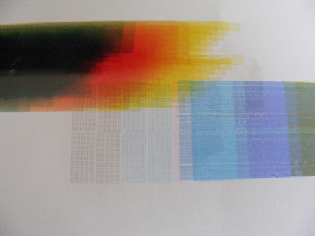

Hello all,
I have a FJ-50 and it seems as if my right printhead has gone haywire. It is dumping plenty of ink onto the media. The image at the top left is when I try to demo print and I just get a huge pool of ink. The image to the right is the test print after a head clean. What are your thoughts?????Replace printhead? Another problem?
