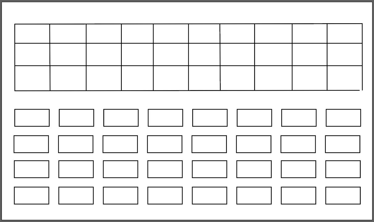

It depends on what you are looking to accomplish. In the attached drawing, the top rectangles were created using 4 horizontal line segments and 11 vertical.
In the bottom the graphic was created using 32 discrete rectangles.

This is exactly what I think I was looking for. Thank you!
Will Flexi read it as one individual line (top photo)?
balstestrat
Problem Solver
If you make it one line it will read it as one line.
Make sure you overlap those ends. Otherwise it might not match the cut.

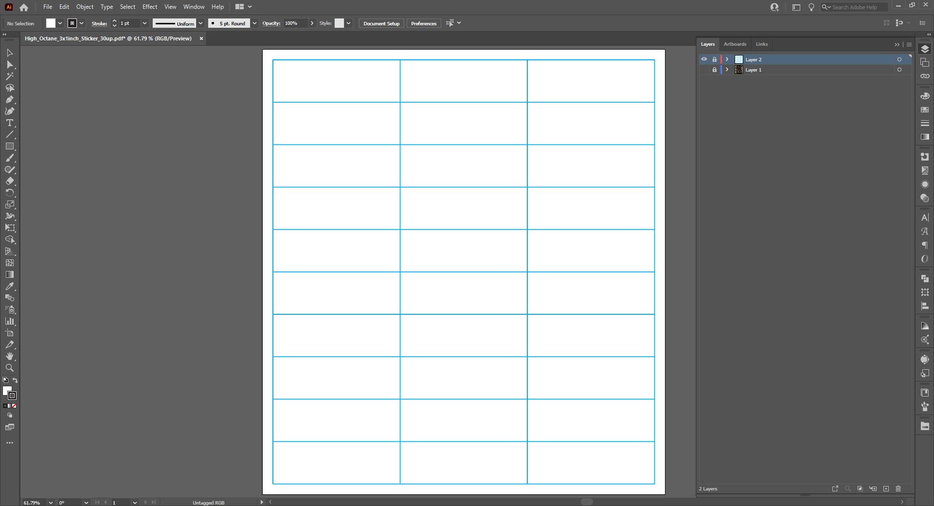

I do this often. I step out the pieces in Illustrator on my sheets (ie: 8.5" x 11") Crop the artboard right to the edges of my stepped items. Then I draw one line across the entire width and another for the height and step those out across the sheet. Definitely saves a lot of cuts when you have lots of sheets to process.
I will do it with stuff that bleeds as long as the butting colors are the same.

So I tried doing it this way but it's selecting the entire image rather than the cuts I wanted to do, I've tried making it transparent but no luck. What could I do to fix this issue?
