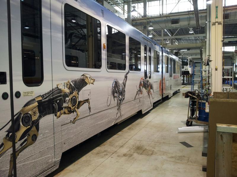

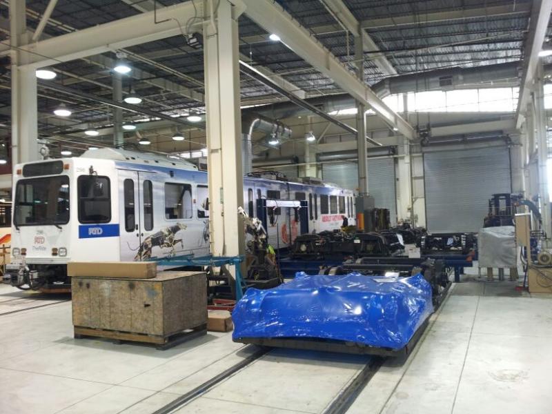

we do these in under 4 hours. 90ftx12ft both sides
3-4 guys
