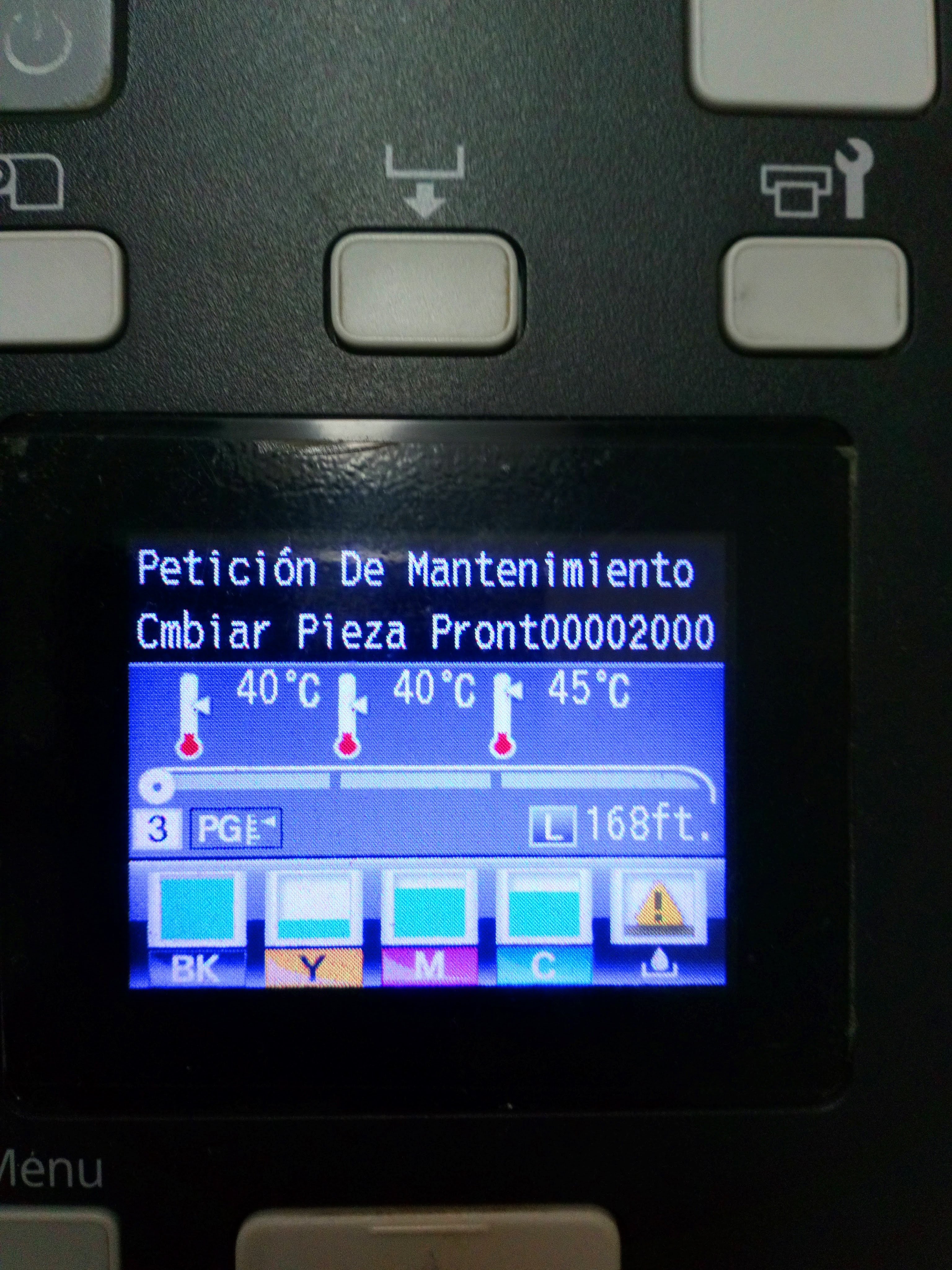

Hello !!! I'm getting this request (Pront0000200) on my SureColor S30670, my local technitian hasn't been able to find what it is. Anyone here knows what it is ?

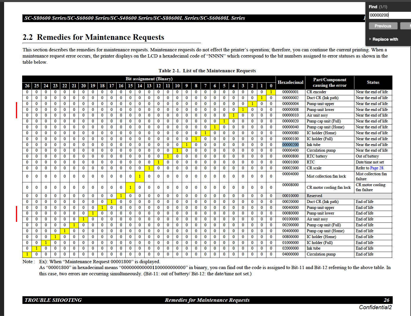

That has to do with the ink lines. After so many hours they recommend replacing the lines, but if you have no ink leaks no need to replace really. Just say yes to wanting to still use the part, confirm and it'll go away for about a week, then do it again. Only way to clear the error is using the service program, but you can love with the error popping up from time to time.
