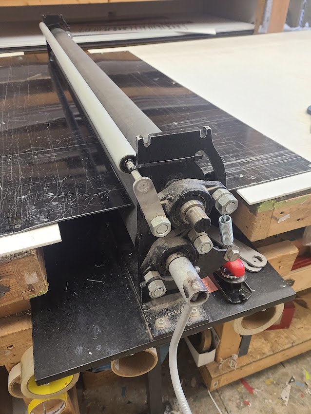

Manual vinyl applicator
Does anyone know what this device is called, and is there anything similar out there still available, in Canada? This one is old, and the rollers have become too distorted to work properly
We're looking at the table systems likes Rolls Roller, but they are very expensive. Wonder if there is anything cheaper out there?

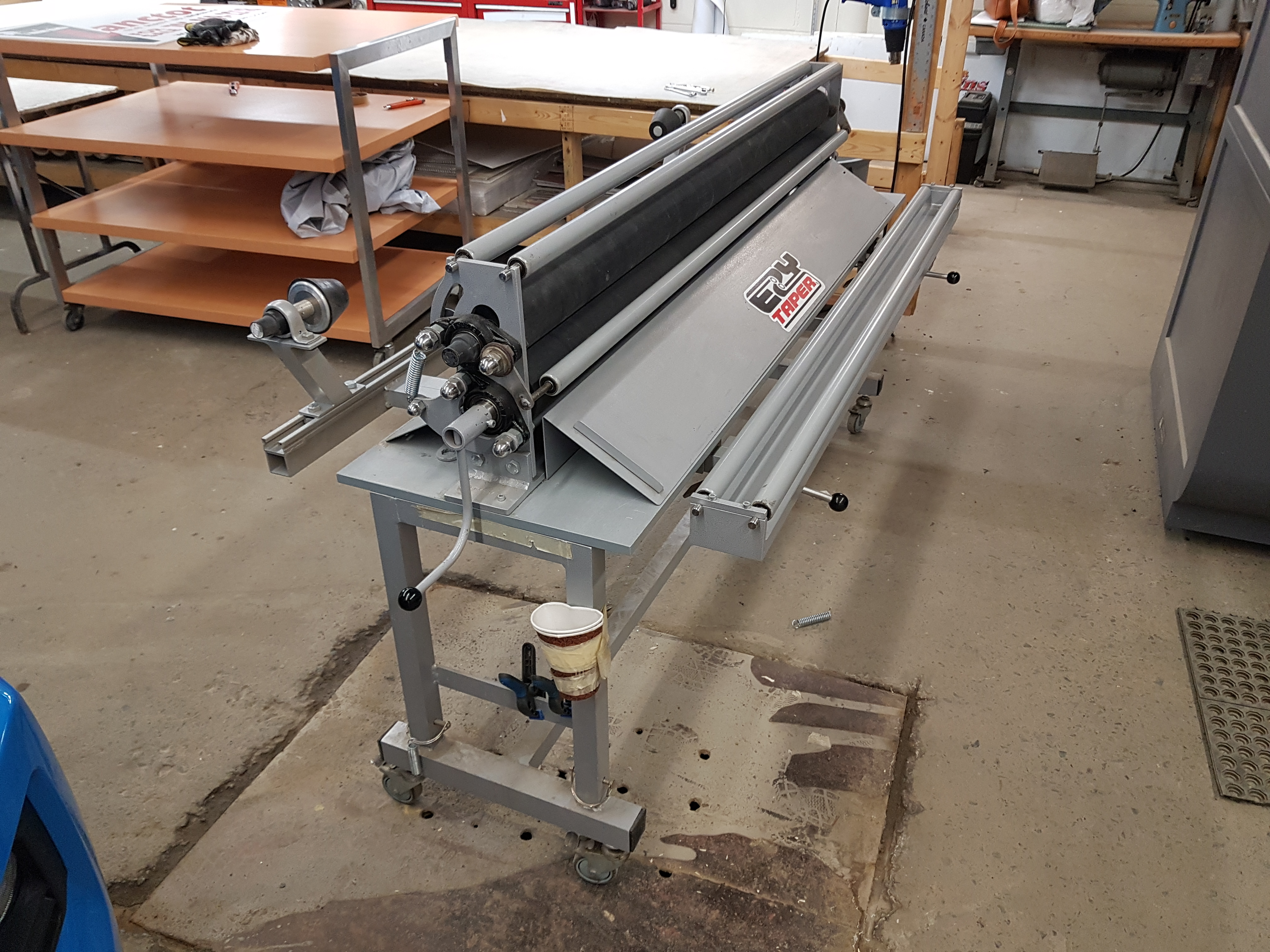

this looks like a "EZ-taper" laminator. we have one as well and we had the same issues. Worked great for years and then started to leave bubbles down the length of a print. We contacted the company. They were originally built in Australia and a Canadian company in Calgary bought them out and services them now. make a long story short, we were told the rollers were finished. Looked into having them replaced and the cost was more than a new laminator. LOL
We still have it and use it for small quick jobs. It still laminates smaller pieces well. Just can't do 48" wide or bigger without having the bubbles issue!

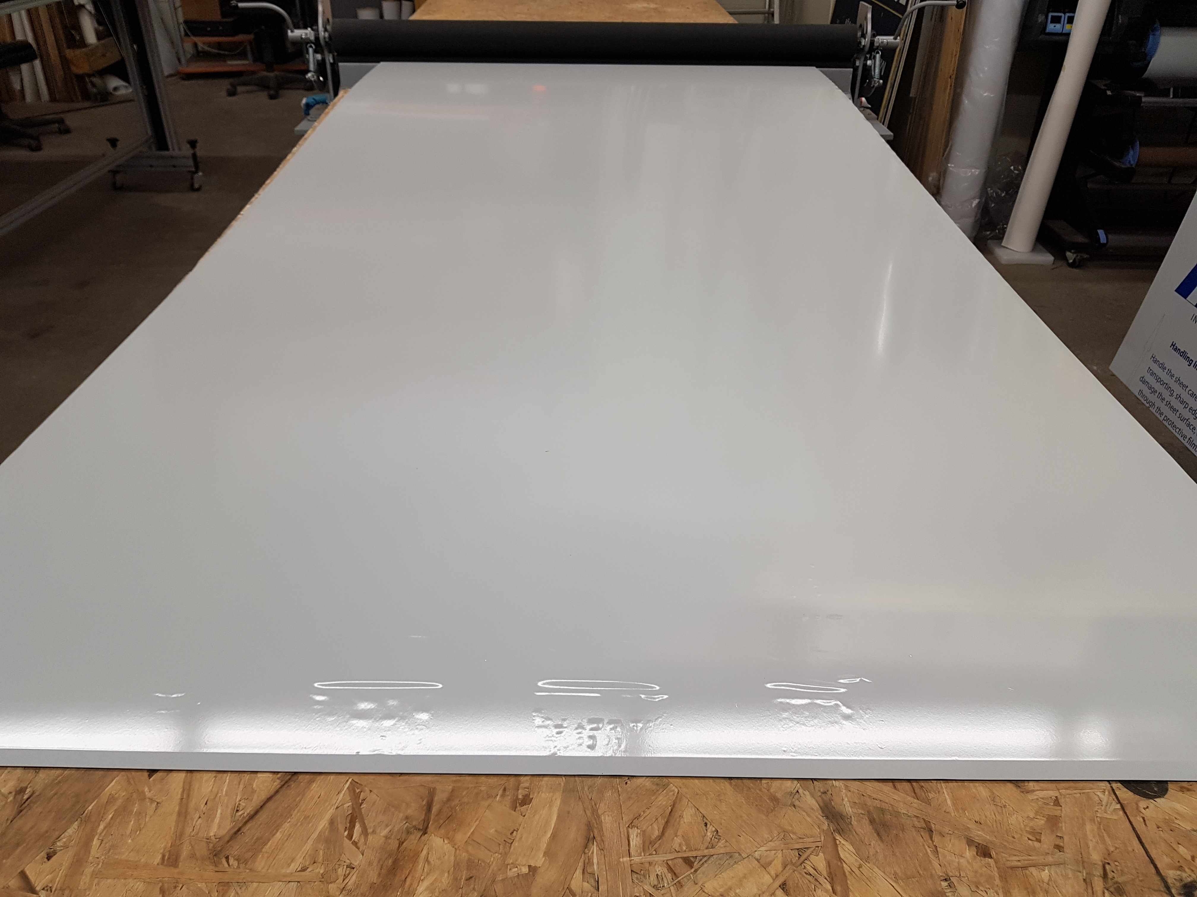

Here is a photo of our "EZ-Taper" laminator. I also attached a photo of an ACP with laminate that was leaving bubbles.
Hard to see on photo but the bubbles are all the way up the 8ft length of the sheet. 3 rows as shown.
