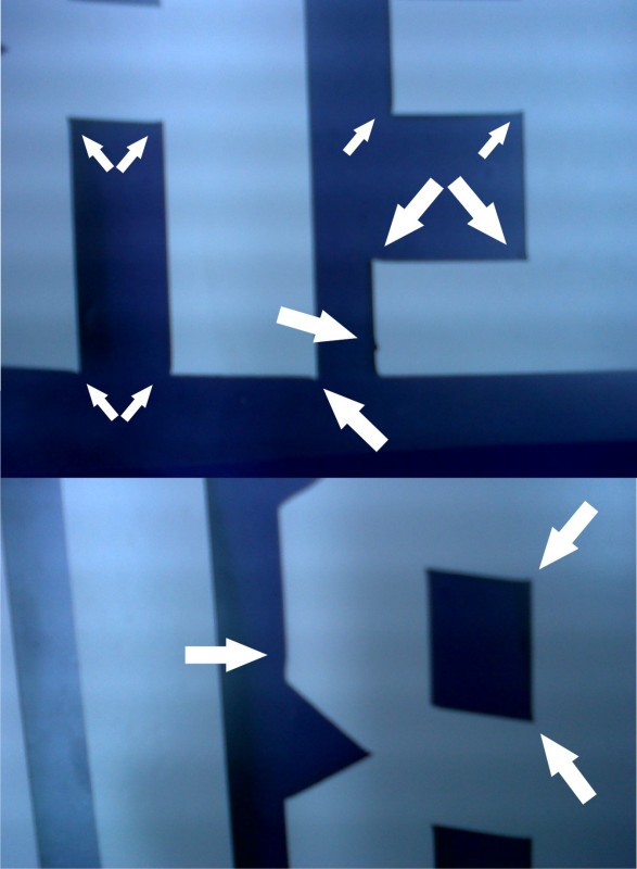

Here is a photo showing the faulty cuts I was trying to describe. The actual letters, although they appear large, are actually 3" letters. This is Thermo-Flex material cut with a 45 degree blade at a speed of 700.

Signmeup - mine was set at .03 ... I'll run it in the morning and see if dropping it to .02 makes a difference. BTW, the pic is so fuzzy cuz I was holding my phone at .04 while taking the pic! Ha!
Off set is a bit fuzzy to me but as I understand it, it is the distance from the tip of the blade to the blade shaft. If I have it right it is possible that your blade was ground wrong somehow too. Did you change blades around the same time you started having trouble?

Yeah. I can move the cutter head back and forth too. Is the problem funky corners? A decent pic would be a big help.
