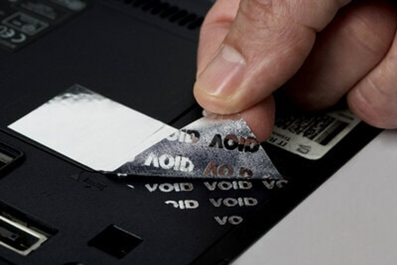

I'm trying to bid on a job that has this requirement "Material must be tamper-proof. Decals must include a die-cut self-destruction feature that prevents removal in one piece from the surface in which it was applied."
It seemed to me that this meant some sort of perforated cut along each decal that would tear when trying to be peeled up after installation. My designer said it was referencing tamper evident label stock, where when you peel it the top layer comes off and another layer is revealed that says VOID. I still think I'm right, but I need some backup here.

You are looking for Geber White Security Label Stock P82891A (2mil). Has the VOID peel feature. As for the self destruction feature, I am unsure how to do that.

When you remove stickers from tractor trailers and other things, you will find it says void all over the sticker. Not sure if the coating makes it not seen, but it's there so you cannot lift the stickers and use them somewhere else.

3M also has the fancy ones like these, part numbers 7613 / 3812 / 7381 / 7866 / 7380, they leave printing behind when removed, some leave the word "void", some have triangles... They only come in 4.5" & 6" wide 1668' long rolls. If this is what they want, something that not only destructs, but also leaves a tamper mark, it's only worth it if they commit to buying large quantities (thousands) to make your investment worthwhile, 6" wide rolls run over 2 grand. Had some samples of I think the 3812 for a job we were bidding on once, it did print on a solvent, but if we had gotten it, we were just going to add a 6" thermal printer to run them separately. Some other company got the job, but that is some really cool stuff.
