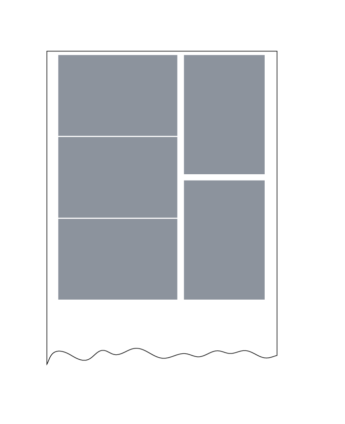

I'd probably do them in groups of 5. 3 landscape down one side and 2 portrait alongside them and repeat.

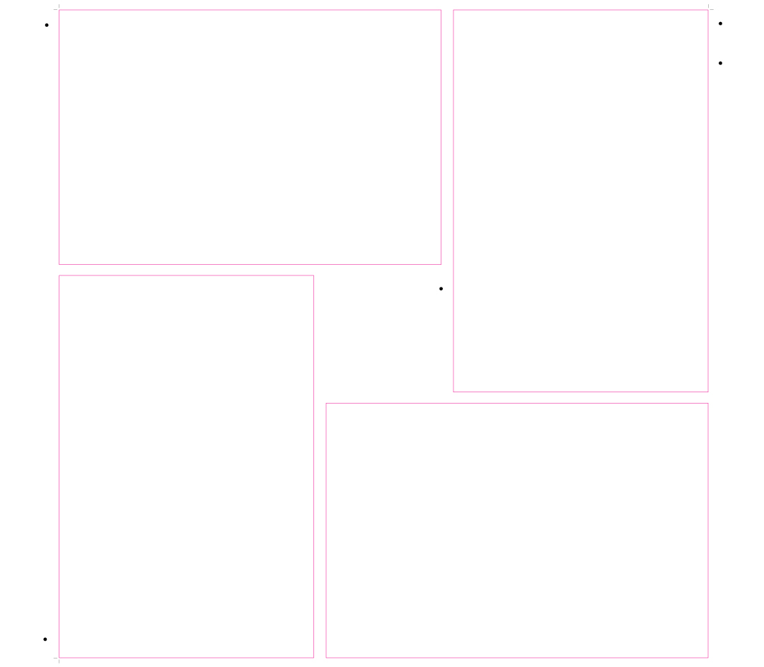

But this would probably be even better.... 61” x 100’ 154,9 cm x 30,5 m 1 Roll KPPS61 Kodak Satin

We are using our Colex Flatbed cutter to trim these. I linked to the cut template above that we use on our 60x42" prints.
