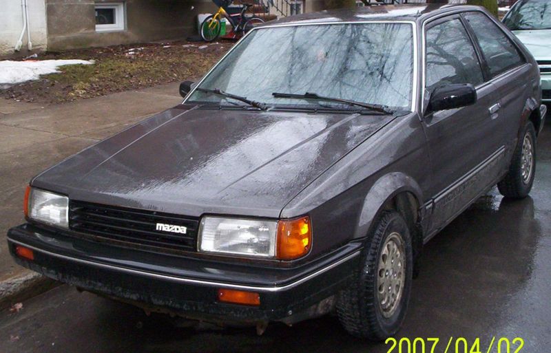

Doing a wrap for a friend who fixed up his moms old mazda 323 iKat from 1989 (don't ask why he did it. he's just mental about that car). I've searched and searched for an auto template, but all I've been able to find was a badly done jpg.
I know this is not the car you usually do a wrap on, and i might be able to do it without the right template, but still would like to find it, if it's out there.
The attached image is same kinda car, not the actual one.
If anyone knows about a database of old cars, please let me know..... or maybe a great way to do it without the template???

With an older model like that it might be best to take some good photos (assuming you have access to the car) and then back them up with careful measurements of the major features of the car to use as key points to check the scale and distortion of your photos.
If you take the photos stand off as far as you can and try to avoid using a wide angle lens - use something with a little reach (50mm and up) to minimise the distortion of the panels. With a little planning it should take less time than searching the web looking for that car.
That being said you can go here:
http://www.smcars.net/
and register.
They have a front/back & side view drawing of a 1988 mazda 121(?) that looks similar to the photo you posted - there are a few others there similar (88 mazda 323 gtx) but the search does not always work and you might have to look through 8 pages of mazda blue prints....
