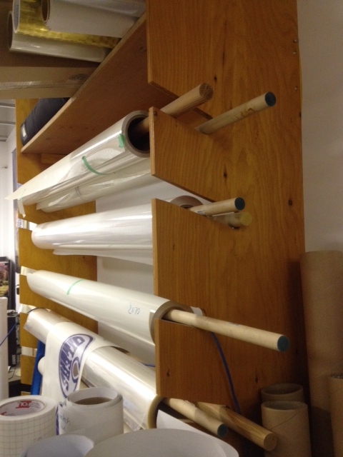

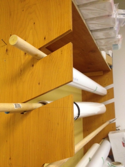

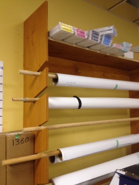

For our 54" rolls of vinyl and laminate, we built some "rifle rack" style storage units. We "hang" the rolls with a 1" diameter dowel through the core of the vinyl. Works great for us.

This is actually what I had envisioned (rifle rack style)...you happen to have any pics you'd share so i can see how you did it!? Do you find the 54" rolls to be "tricky" to get on/off the dowel when loading / unloading to the printer? That was one concern I had...how do you left the roll off the wall, and remove the dowel without laying the roll down and risking contamination on the floor? Or, do you just set the media on one end and slide the dowel out the top? Problem with that for me would be a lack of ceiling height (need at least 10' to do that with 54" film).

Here are some quick pics for you...
As for taking the rolls down, we just lift them off and slide the dowel out. If the roll is almost full, and a little heavier, we set the end on the floor, and lift the dowel out.
Hope this helps.

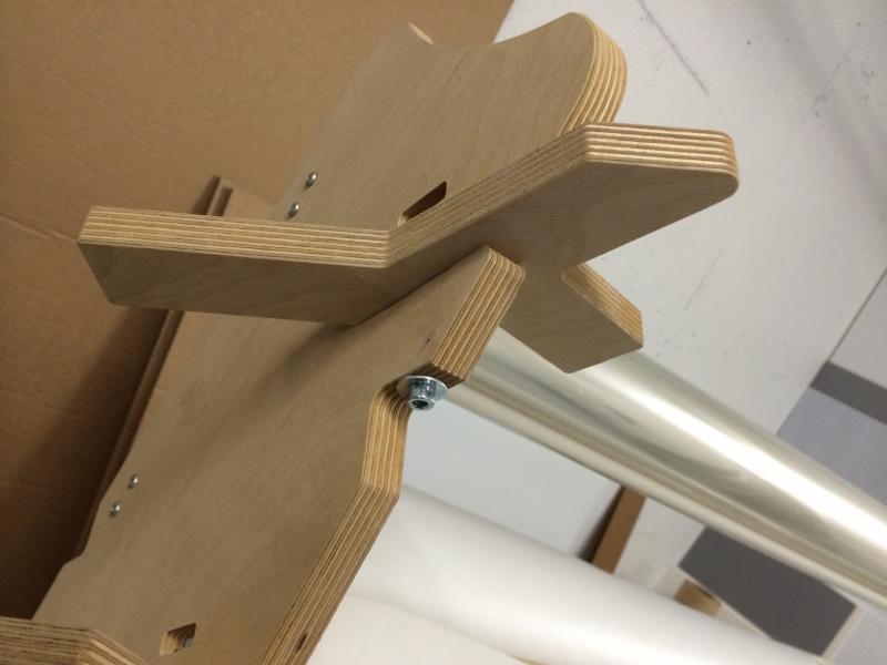

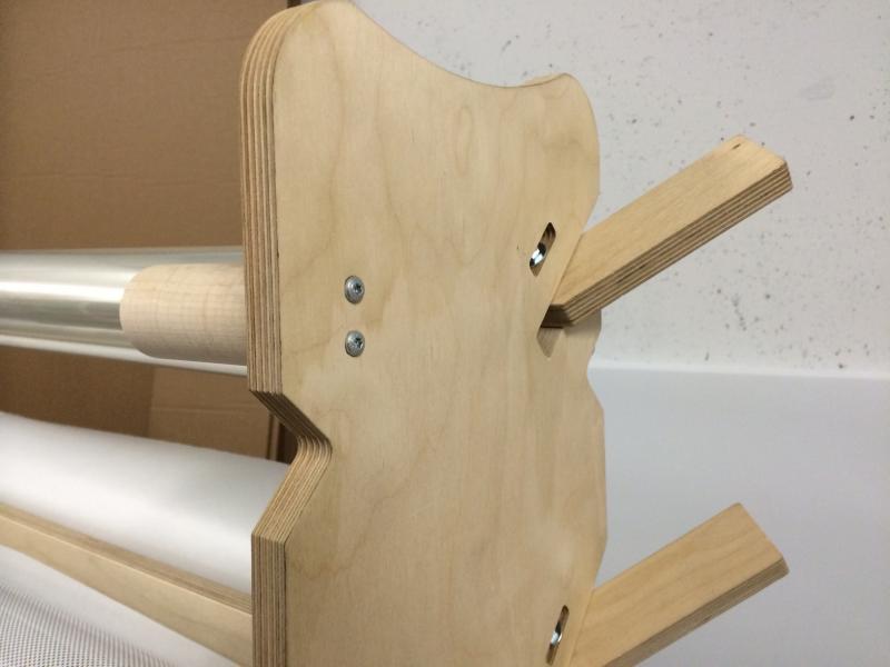

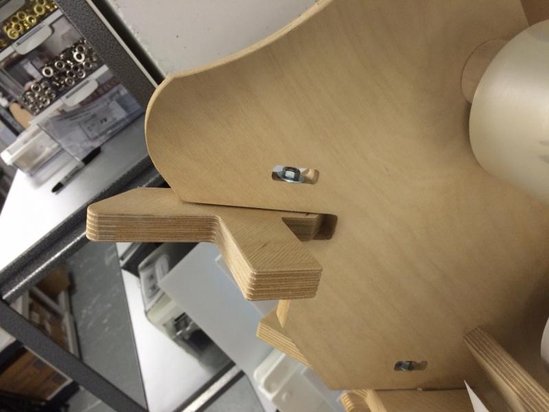

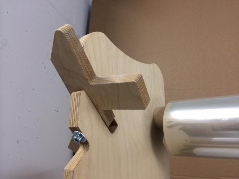

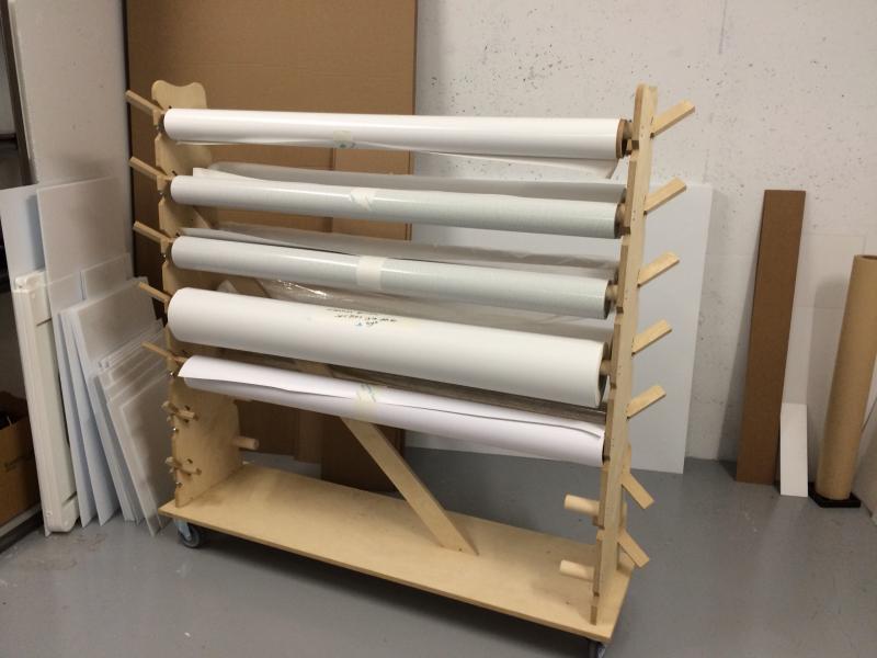

The best rack for horizontal storage I have seen does not use rods, it uses the 3" media core for support so it does not leave marks from hanging on a rod, it uses a movable bracket that pivots out of the way to load or remove the roll from the rack.

Nice rack. :) The system we use does not leave marks on the vinyl/laminate. The rod goes through the core to hang it on the rack.
