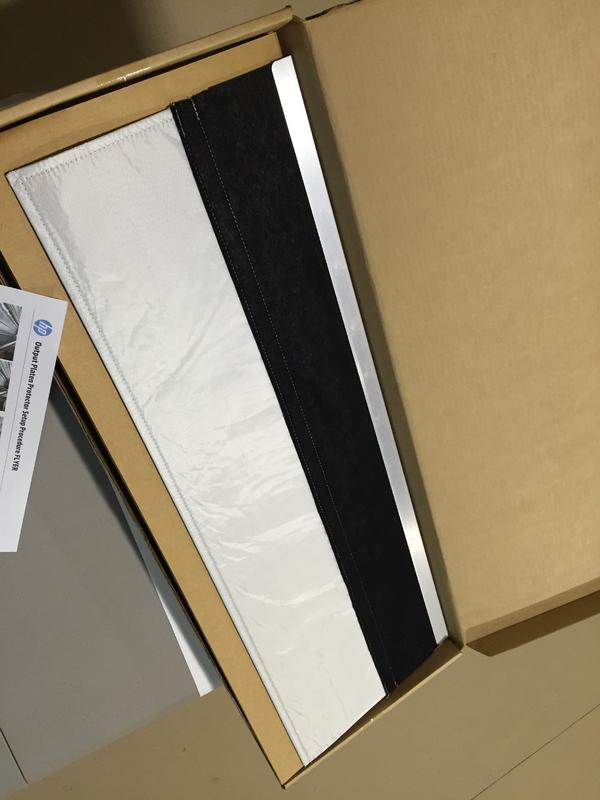

WrapItUp66
What profile are you using for the HP 360 Latex with the UltraFlex Strip Mesh Pro LTX with liner? The same thing jsut happened to me, I watched it curl up in the curing unit and looked up at the platen area and crash! Luckily I was able to catch it in time but I used a seal mesh profile and it seemed to be working fine until it buckled.
I am attaching a picture of my platen protector. is this what you were talking about?

ProColorGraphics
Yes, that is the new style of platen protector. I think I just used a standard banner profile. I probably turned the heat down a little, but nothing crazy as far as changes.
