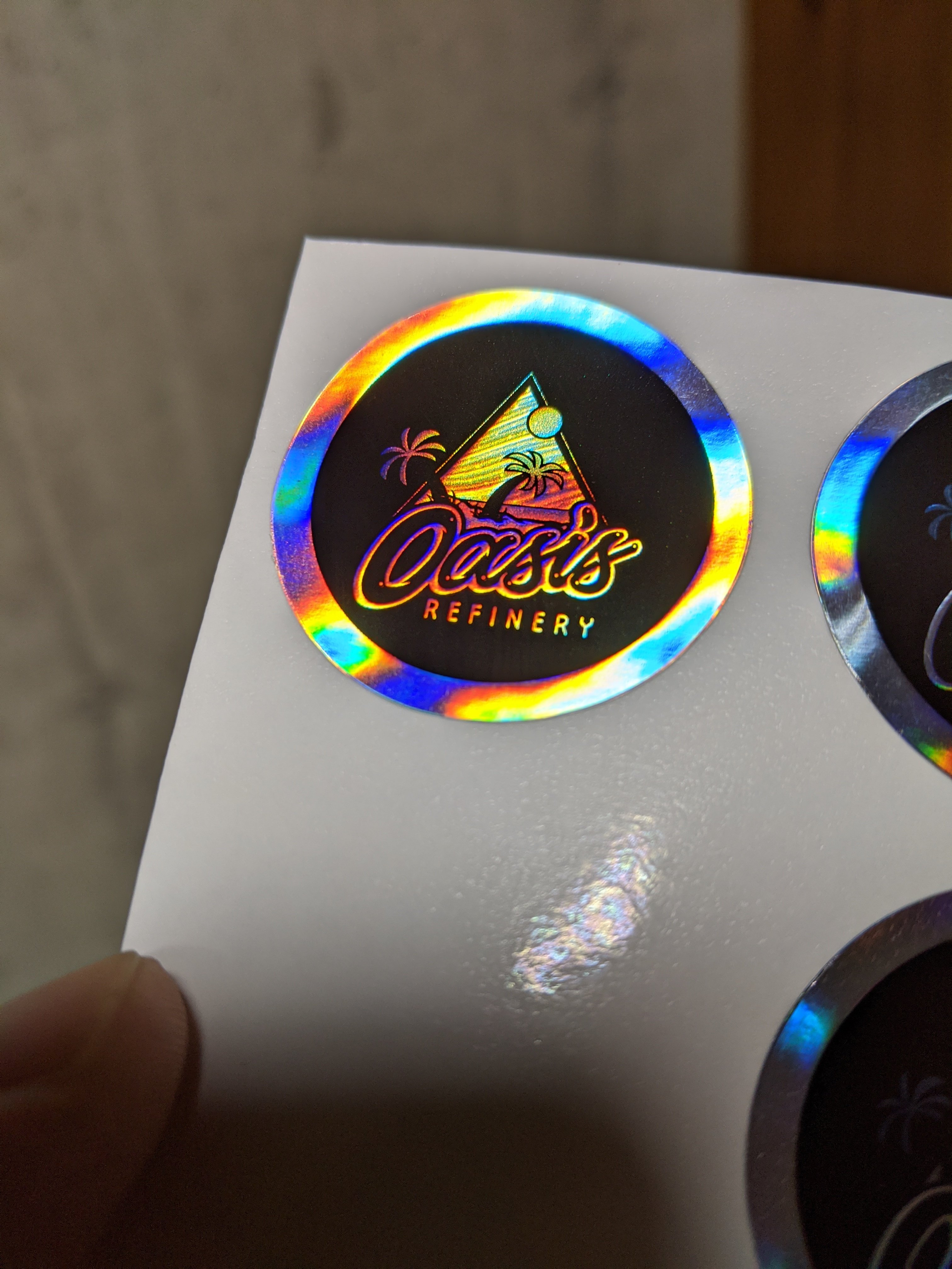

This is what I mean, the first time I tried it I was unaware of having to leave a gap. Printed some and came back next day and they were severely curled.

I've printed on RTape smooth silver before using a Roland VS-540, let it out-gas for SIX weeks, followed by laminating then cutting and it still curled where it was cut through the bleed.
We got around it by using a UV printer to do the print, instant lamination and cut and no more curling. I think the solvents managed to permanently affect the adhesive somehow despite drying for an eternity.
It may be possible that Stickerapp is using something like a Gerber Egde or Summa DC5 as thermal printers don't have these issues.
Haven't tried it with our S80600 but have some leftover material I might test for research purposes.
UV and screen printing is the only ways I can see doing them with bleeds and not having any curling issues.

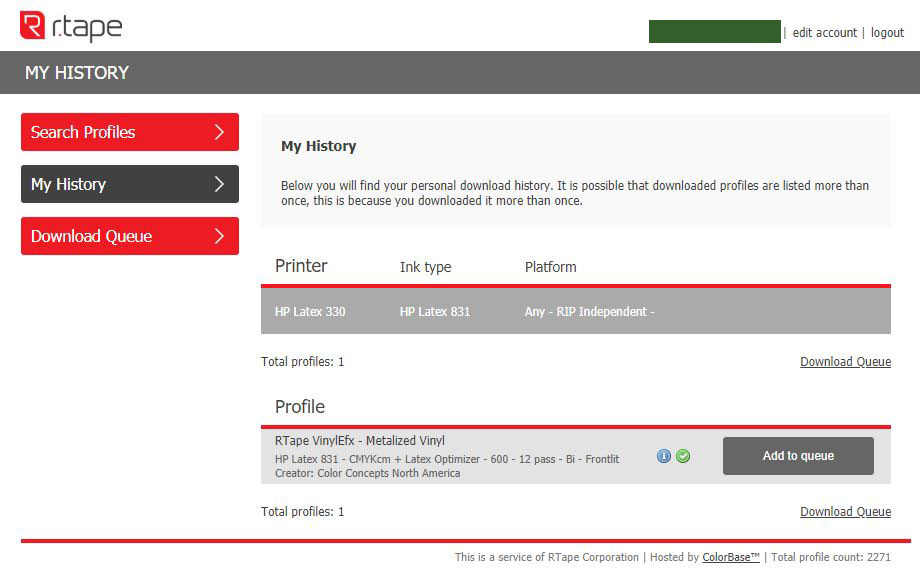

Not sure, they don't list latex as a supported ink option. I wonder if the heat is too much for this material?
Now that you mention that. You really cannot use high heat on this material. It will tunnel like crazy.
Media profiles for HP Latex 300 Series printers are listed on the RTape web for RTape VinylEFX media among others. See attached.

So I tried the silver and holographic through my latex using the rtape profile, which uses heat of 199F. Talk about failure. Makes you wonder if anyone did any testing, considering all of the marketing material for the VinylEFX stuff doesn't list latex as compatible at http://www.rtape.com/M1492_VinylEfx_ProductOverview_8.28.18_PRINT.pdf
I get tunneling with no heat. The stuff is very picky for printing on, but I've yet to find an alternative to it for printing.
