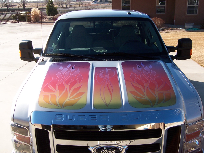

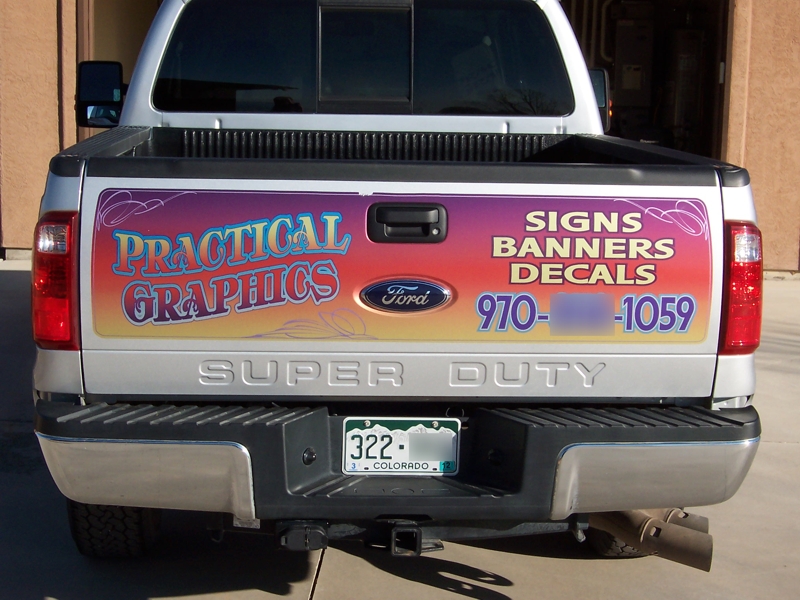

I printed and installed some panels for my truck on the hood and tailgate using the 3M silver and the results were jaw dropping. It gives every appearance of someone having done and incredibly intricate candy apple paint job. The inks, being translucent, become metallic colors with a depth you would not have ever expected.
The reason I tried printing on the silver is that my truck is silver and I didn't want colors on whatever I put on it to be dead relative to the silver paint.

do you have any pics of that? I would love to see it. Any ideas on the print profile? Do you have to laminate?

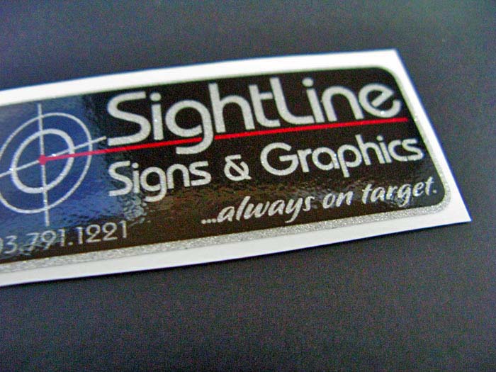

I've not had much luck printing on chrome films but I've really not tired much. Not a big Avery fan but they do have some nice metallics which also print great. The attach shot is on Supercast 900 Ultra Metallic silver then laminated with optically clear Oracal 290GF. Like any print, if you want it to last then laminating is mandatory. They also have it in white and according to Avery's site it is available in up to 48" rolls. Since it's a cut vinyl its not guaranteed free of contaminants but so far I've found that it prints great. :) Tough to photograph it well - it is VERY metallic. White or silver should do very well for print without affecting color much. I tried a sample of the metallic laminates but just was not as happy with the effect.
One thing I have found - I had to recalibrate OPOS on our Summa cutter, the metallic effect made it unable to find the registration marks for contour cutting. No biggie to do really - it has instructions right in the menus to do so and once I adjusted the sensitivity it finds the marks fine.

Here's a couple of pictures. The ding on the tailgate is courtesy of the dim-bulb at the feed store dropping a bale of hay so that it slid down the tailgate. The pictures do not do justice to the actual colors.
Printed on a Mutoh 1204 and contour cut with a Graphtec FC700.
For a profile I used the same one I use for most everything, Oracal 3651G. Since the white point of the media is so far removed from anything resembling white, the profile really doesn't matter all that much. Whatever comes out of the printer is what you get. The printer is the truth.
These aren't laminated since I didn't know how it was going to look and might have ended up removing them. I just gave them a coat of Clear Shield. I may well end up making some changes here and there and redoing them. Those I'll laminate.
The only problem I had was contour cutting. The plotter couldn't read the registration marks on the silver vinyl. This was easily solved merely by shining a flashlight beam on the media beneath the plotter's mark sensor. The plotter picked up all four marks this way.
