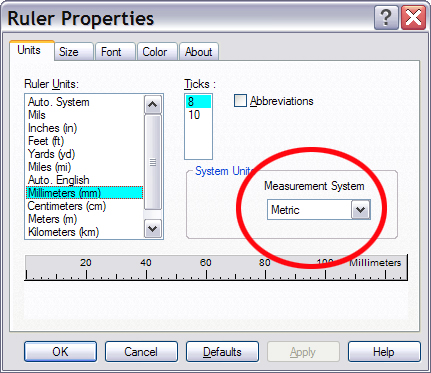

To change the entire system to metric, you must change the Measurement System setting.
  • Right click on rulers
  • Click on Properties
  • Select Metric on the drop down menu

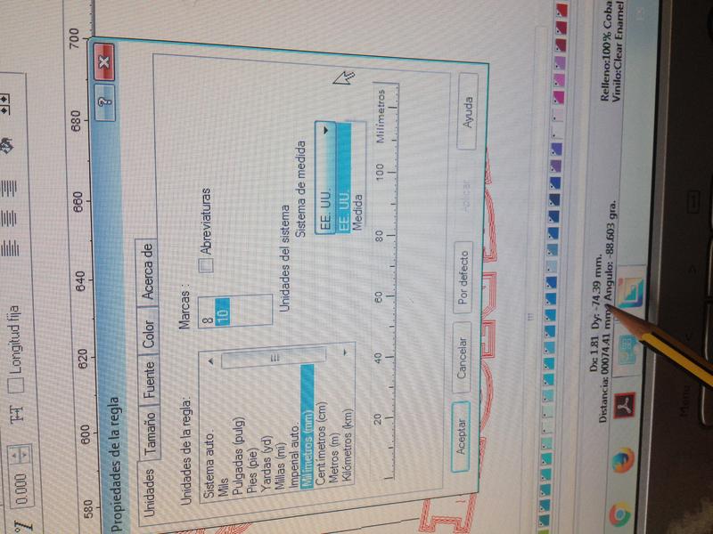

Thank you Fred, I go to re-install Omega and SP1 again because, my system not shows the option METRIC on the MEASUREMENT SYSTEM Dialog Box, I only have two options: EE.UU or MEDIA.
Thank you for help me ;)
Hielorojo
The solution is a little confused, to work in Metric system I have to choose Millimeters in RULER UNITS and EEUU in MEASUREMENT SYSTEM, There is not option of METRIC....but now work well in Metric ;)
