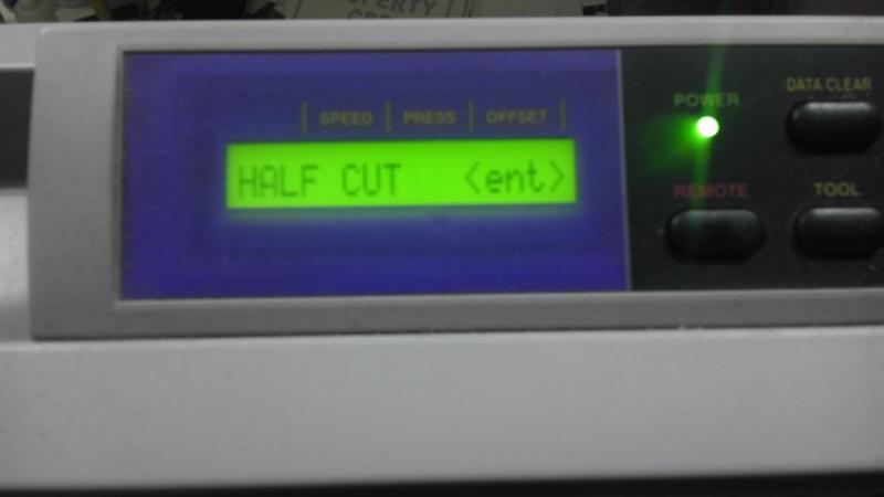

The half cut is your die cut function :banghead: LQQK a little harder on your plotter settings on the plotter it's self, half cut is in there.
ChicagoGraphics
This is what you should see on your control panel under functions, use the up or down keys till you reach it

So... yea im dumb and I apologize but it wasn't in my tools. It was disabled in the setup. So last night I ran my stickers and prayed to god my test cuts on some junk paper work.
id say I had about 90% success!
They all were still in the material so I had no issues with the grit rollers. They punched out easily as well.
My only problem at first was I forgot to move the blade forward :banghead: but its fixed now.
