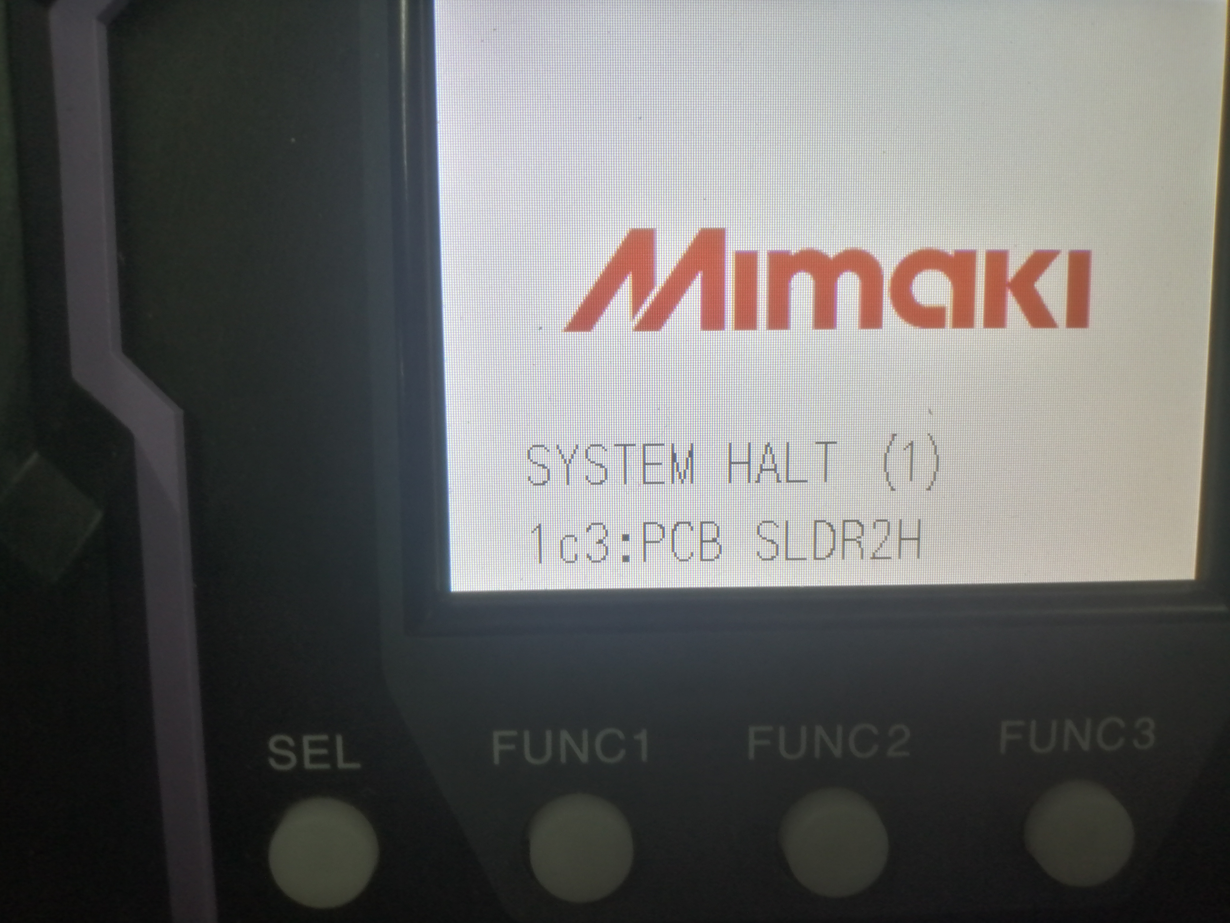

Has anyone got this error or know what it means
Solventinkjet
DIY Printer Fixing Guide
It means the printer isn't seeing the slider board. Either it's unplugged, the slider board is damaged, the trailing cables are damaged, or the main board. I would double check you have the trailing cables plugged in correctly on the slider board to start. Check for damage.
PJ758
yes everything is intact, error occurred after a powered fluctuation.
