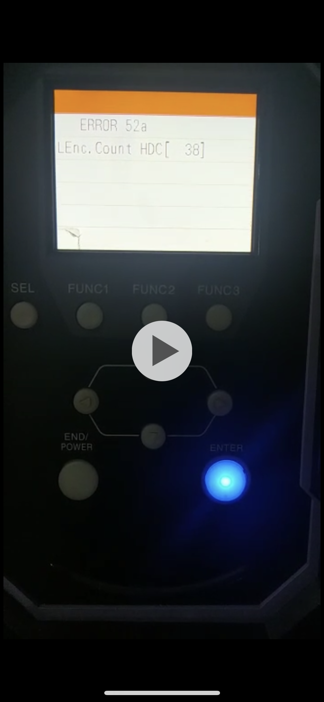

Need Help Mimaki CJV 150-75 , error 52a Lenc count HDC
vtriplesix
This is the error message

It means the encoder isn't being read properly. If it's intermittent, you probably just have some ink splatter or grease from the rail on the encoder itself. You can clean it with a lint free cloth and alcohol.

thank you for your help , i got the encoder tape replaced today , but still have the same error message , is there any other parts that might cause this? or the new encoder might have defect?
