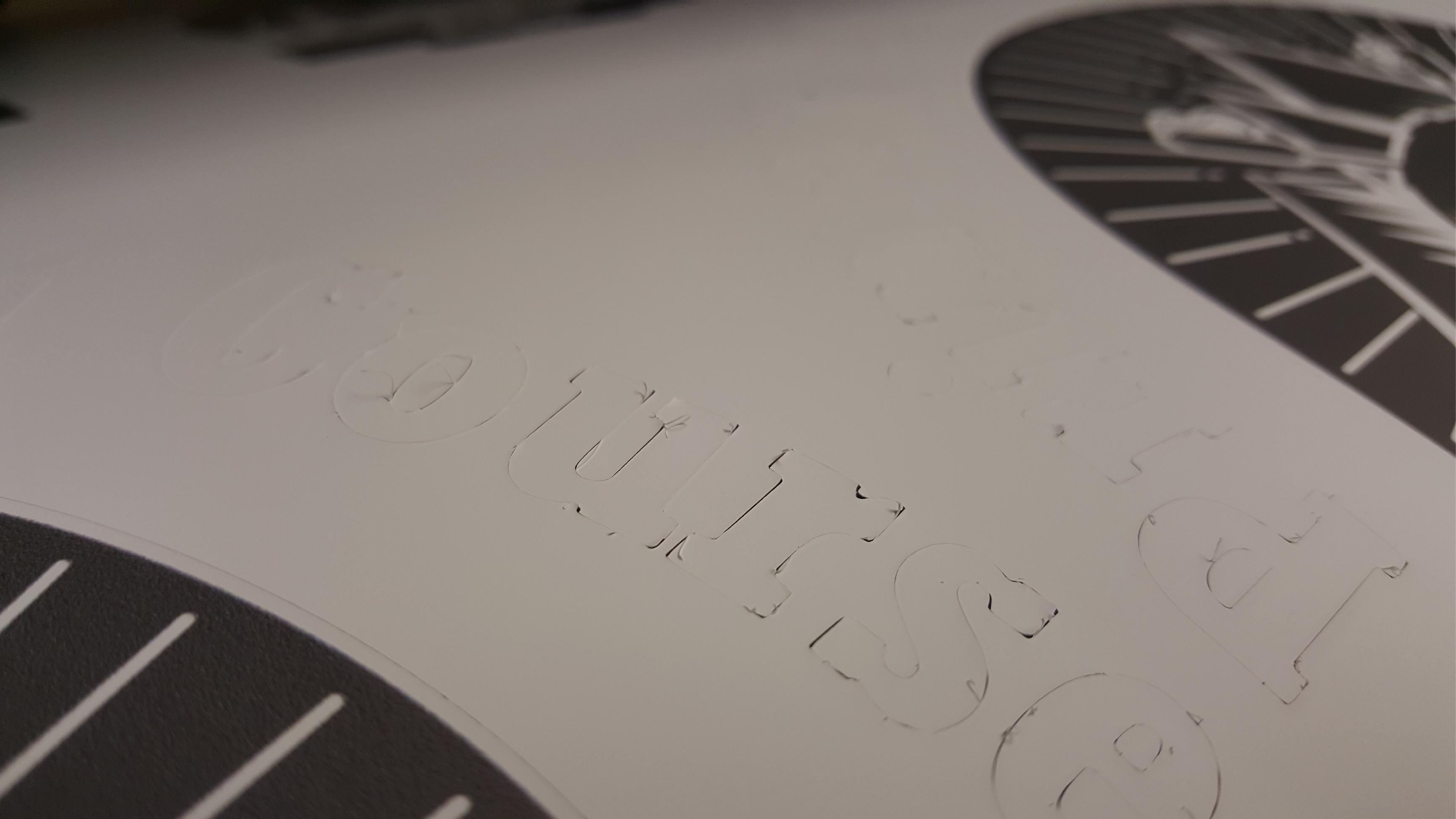

Hi everyone,
I have this issue with a few of my files, but not on some. I have compared all aspects when using the rasterlink plugin for illustrator.
All have a stroke of 0.001pt with 0 fill, set to CutContour (as stroke colour)
I am baffled as to what it can be. The text should cut a single line as it has with my previous files.
Has anyone had similar experiences? If so did you fix it?
Attached is a photo of result.

Upload the file and we can take a look. There is no way to set the printer up to cut twice. It has to be the file.

I believe this is the fix you're looking for. It's a CC issue, but this is the work around provided by Mimaki USA.

Also, a fill and a stroke counts as two separate entities. Plotter will cut both.
