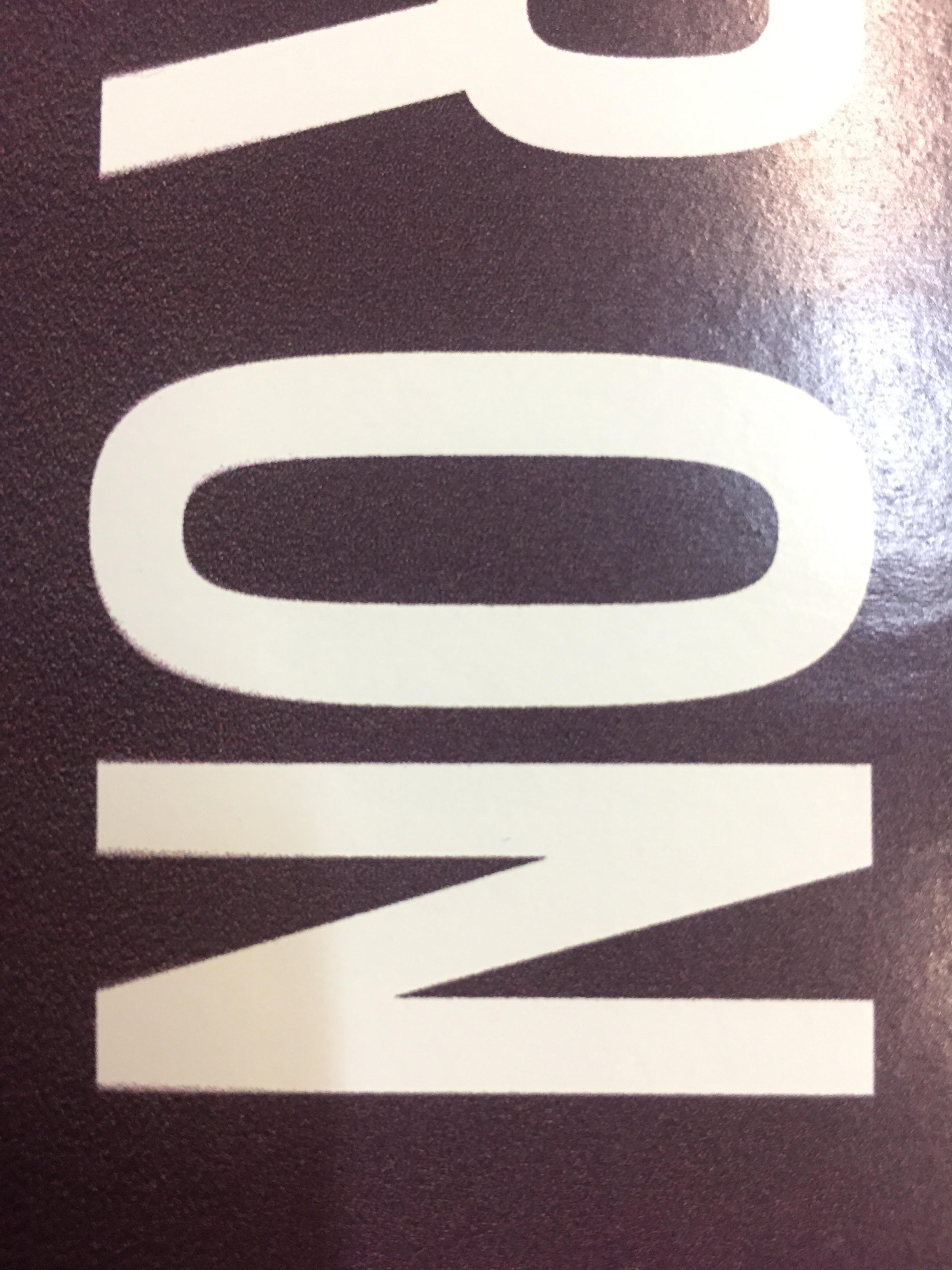

Hi there!
I have the mimaki cjv 30-130 printing ALMOST perfectly, however, every inch or so I get a blurry edge. This of course looks worse when there is test, it makes it look bold. It doesn't matter what pass it is on. Anyone have a solution? I have tried everything I've found but nothing has worked. Our nearest tech will cost about $1000 to get here so I'm trying what I can on my own first. I have noticed the printer seems to be running a little 'hard', with the waste container now shaking.

Have you tried adjusting your feet compensation? Adjust>feedcomp
