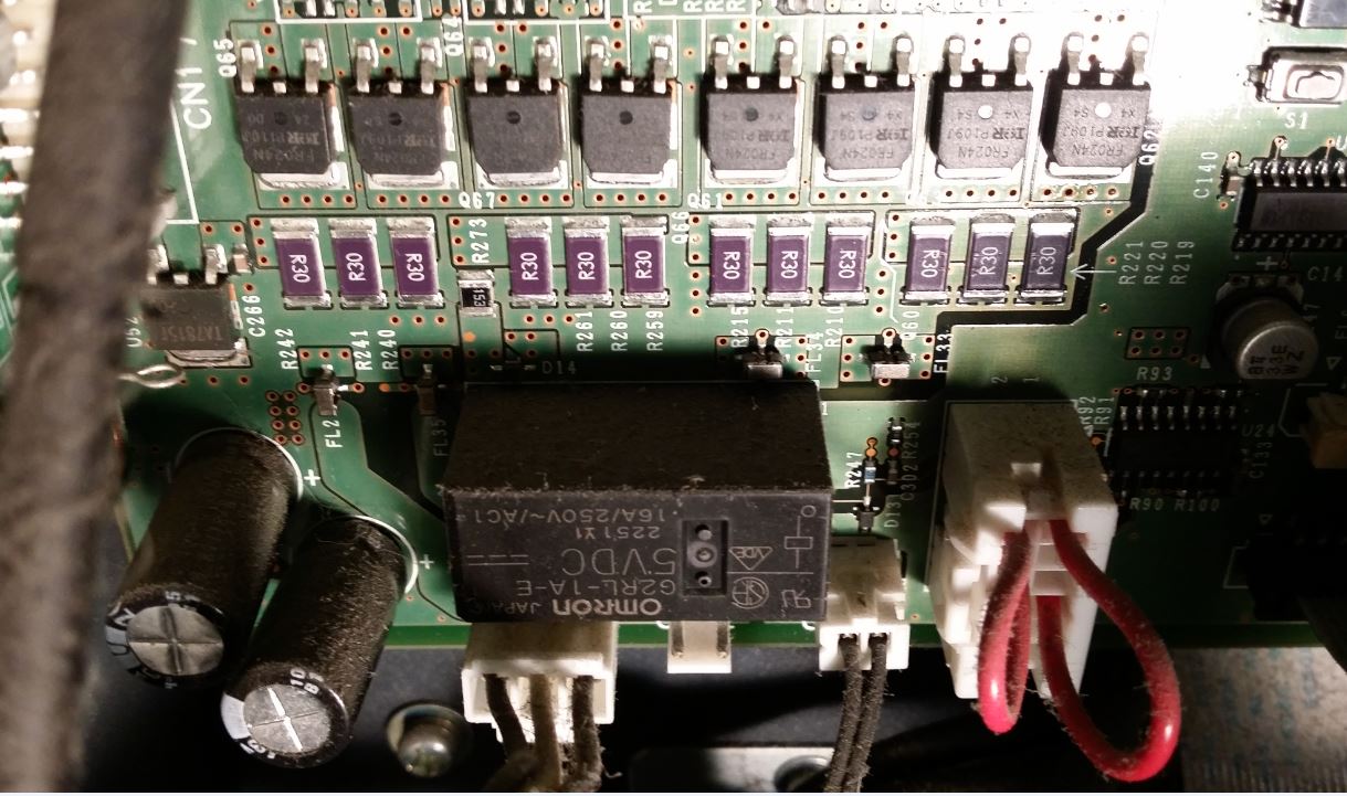

kensign
Is this the jumper . does it come off easy
