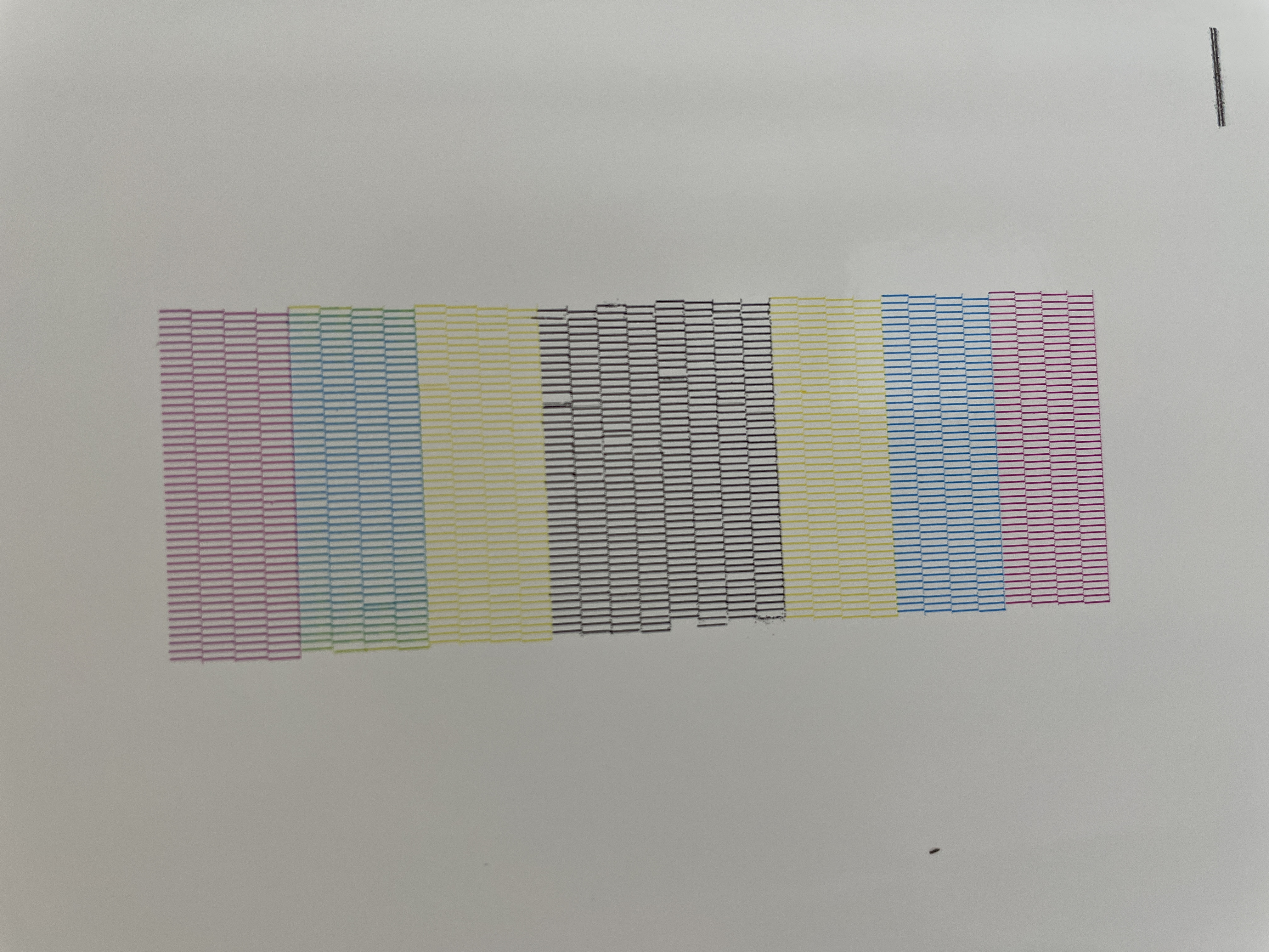

Hello everyone, Does anyone have an idea how I can correct the error in the black field? Here nozzle fields seem to be shifted. Greetings Andy

Looks like you have a little nozzle deflection. You could try a head soak, maybe change the cap tops, if neither help, then you're probably looking at a new head. Is it causing issues with your prints?

To me, that seems much more then the deflection in your test print, that more looks like something is out of adjustment. Did you have a bad head crash before this issue started?

Ok, I'll test that, let's see if it's better in the morning. Is there a guide online to change the print head yourself?

I don't know as I don't have a Mimaki, however, I would imagine there should be imagine, as there are for Roland. I would leave the head replacement as a last option, as it would be your most expensive option.
