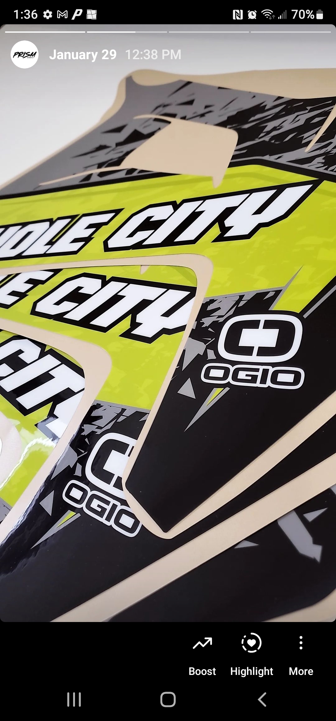

The first photo with half of the "City" logo is an old print, which is what I think is correct. (Laminated)

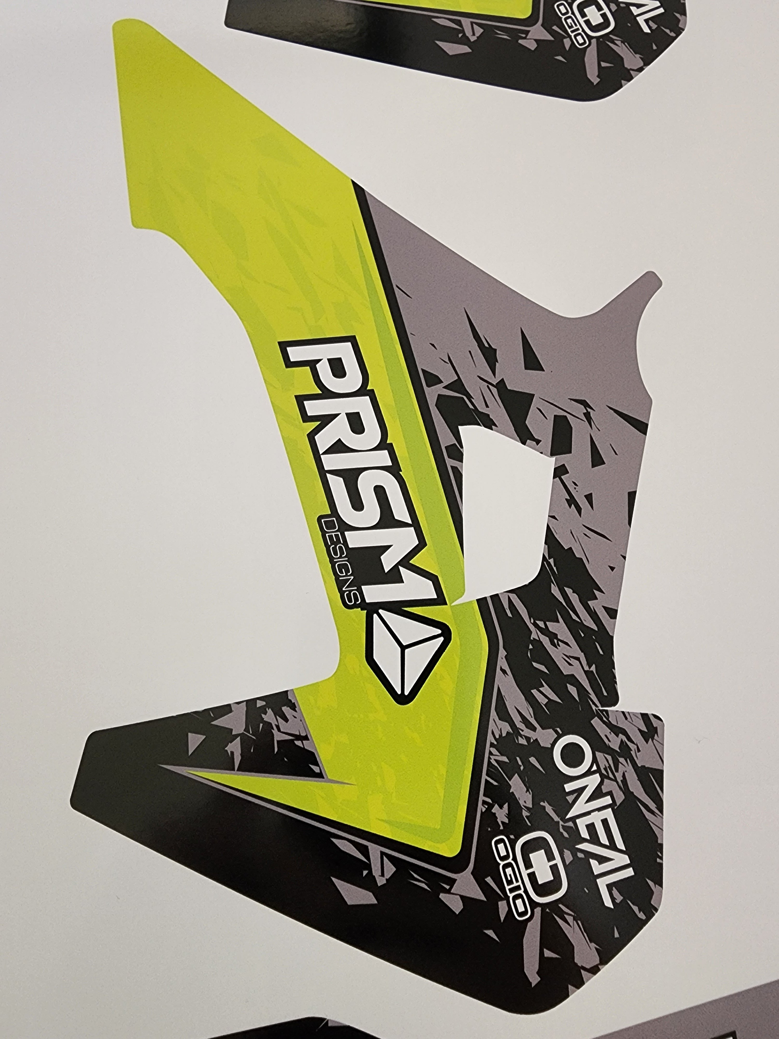

The second photo with the "Prism" logo is what I am getting now. (Not laminated)
I printed several times with different profiles - also with color matching on and off, and I think its starting to look better. I am going to use a different profile all together and just tweak my colors in Illustrator a bit for now.
Honestly, I have not really been using the printer much in the last 6 months at least. I had been busy with traveling for work and this is just a thing I do on the side.
I am probably nitpicking the difference in colors, but I want everything to look that way it is supposed to. :)
