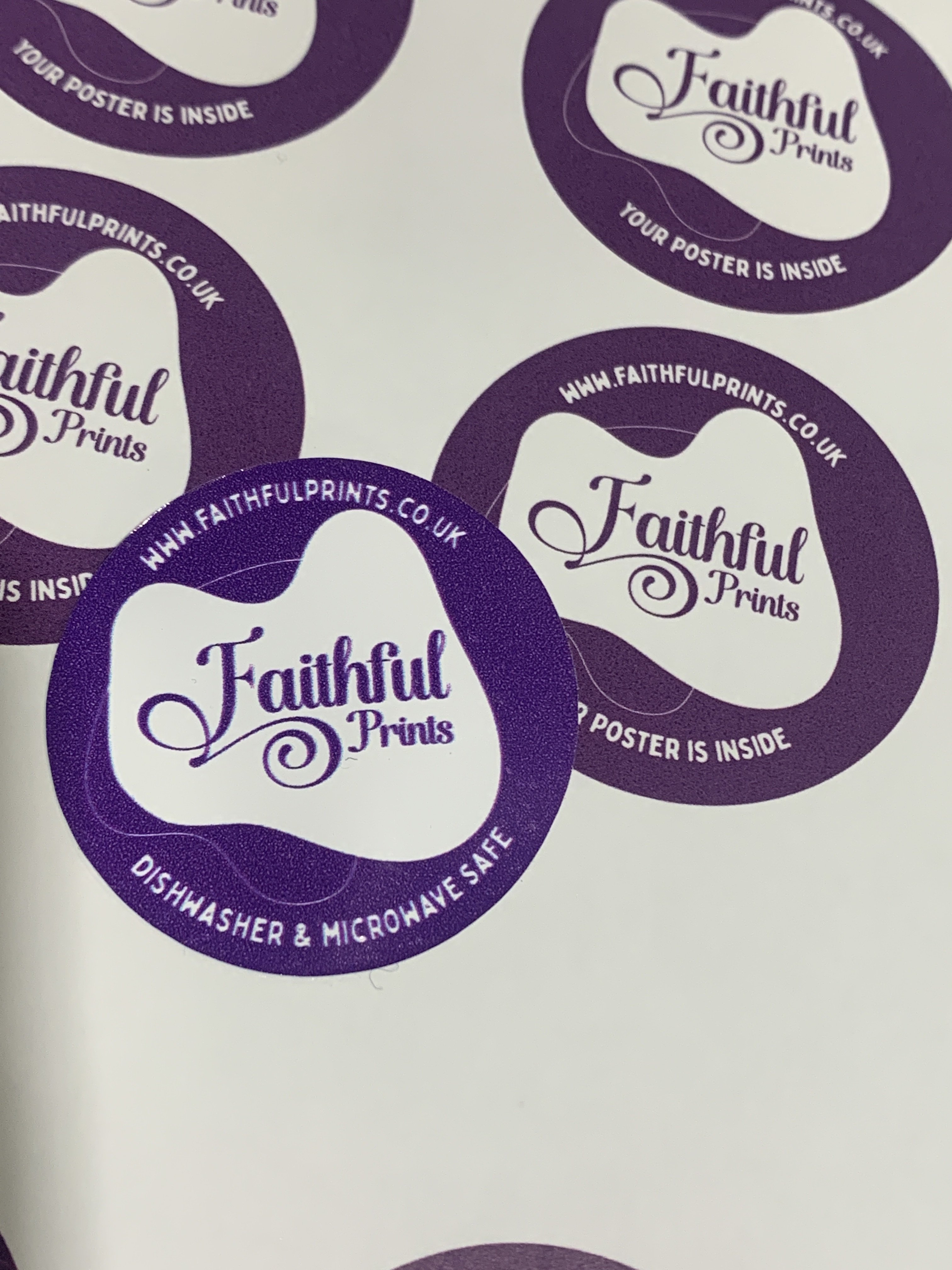

I’ve recently acquired a mimaki cjv150 and I’m trying to print some stickers but having a tough time with the colours being wrong.
My printer is using the CMYKLmLC ink set and I’m using the media profile for the vinyl
I’m printing onto which I downloaded from the mimaki website.
I’ve done the artwork in RGB as I’d read to use rgb and let rasterlink convert it.
I’ve attached a photo of the sticker printed on my Epson wide format inkjet (the ‘paler’ ones) and also the same colour printing on my mimaki (the ‘brighter’ sticker). Neither is 100% correct but the Epson one is much closer to the artwork and the Mimaki is way off.
Any tips would be very much appreciated as I’m a complete newbie with this and feel so out of my depth.
*thankfully the stickers are for myself so not a customer order*

The best way to match colors between printers is making your own custom color profiles. Even printers of the same brand and model can print differently without calibration. Do you also send RGB files to the Epson? If not, try sending the CMYK file to Rasterlink. It might get closer for you.

I'd get rid of the light ink and use a GPVC profile or one made for the media. There are a lot more options for pre-made CMYK profiles, color gamut is the same and it prints faster. Making your own profiles will probably not be an easy task for you to master at this point.
