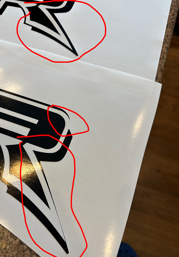

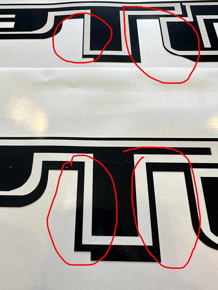

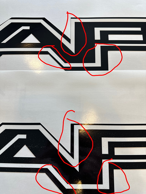

I have a CJV150-75...I'll print an image with registration marks, laminate it, then put back into the printer for contour cuts and its consistently inconsistent. I am using Flexi for everything. Seems like the first foot is great, then accuracy falls off. I thought it was me loading the media in wrong, but that doesnt seem to be it. Using a separate plotter to cut the media isnt an option. I'm not cutting any super crazy, and I cannot figure this out. Seems like I clear one hurdle, then run into another. I tried the Scale adjust, doesnt seem to do anything other than print 2 registration marks. The tension on the media is there. I have no idea where I'd even start to adjust the X & Y axis.
Here are some pics on a decal that is roughly 38" tall and about 5.5" tall. I printed 4, and all 4 were cut completely all over the place.

Looks like you're doing multiples of the same file, are you doing them all as a single file together? If so, try doing them as single files (print copies with reg marks around each one individually instead of marks around a bunch of them), that way you're just cutting each as a 5.5x38 file. It'll take longer to cut because it'll have to read the marks for each file, but will probably get you through these till you can figure out the issue. Add some black bleed and it'll get rid of the white showing (I add bleed to all print-cut files), and make sure the heat is off when you cut too. Print-cut devices can be a pain to get running consistent, try lower speeds to prevent slipping, you don't want any tension on the media itself, it needs to move freely, make sure it reads all reg marks, not just a couple...

I feel your pain, it's always tough getting them dialed in, especially when it only does it on longer files... A lot of waste generated working out the kinks, especially when its inconsistent, if it was always the same you could adjust for it. I run a CJV-300, and a pair of cutters too, only used the one on the printer for quick small print-cut files with no lam, and even then it doesn't always do the best. The rest always goes on a cutter. I've always looked at Print cut machines as a blessing and a curse, they can do both, but usually do one function better than the other. Hopefully someone else here can point you to a remedy, good luck.
Ronny Axelsson
I suppose you print and read registration marks in all four corners?
Is it equally bad on left, middle, right part of the material?
Is it better near the registration marks or same for the whole design?
alevit53
Flexi does not play nice with the Mimaki CJV. Use Rasterlink and you'll solve your problem. We tried for a year and gave up with print/lam/cut using Flexi.
