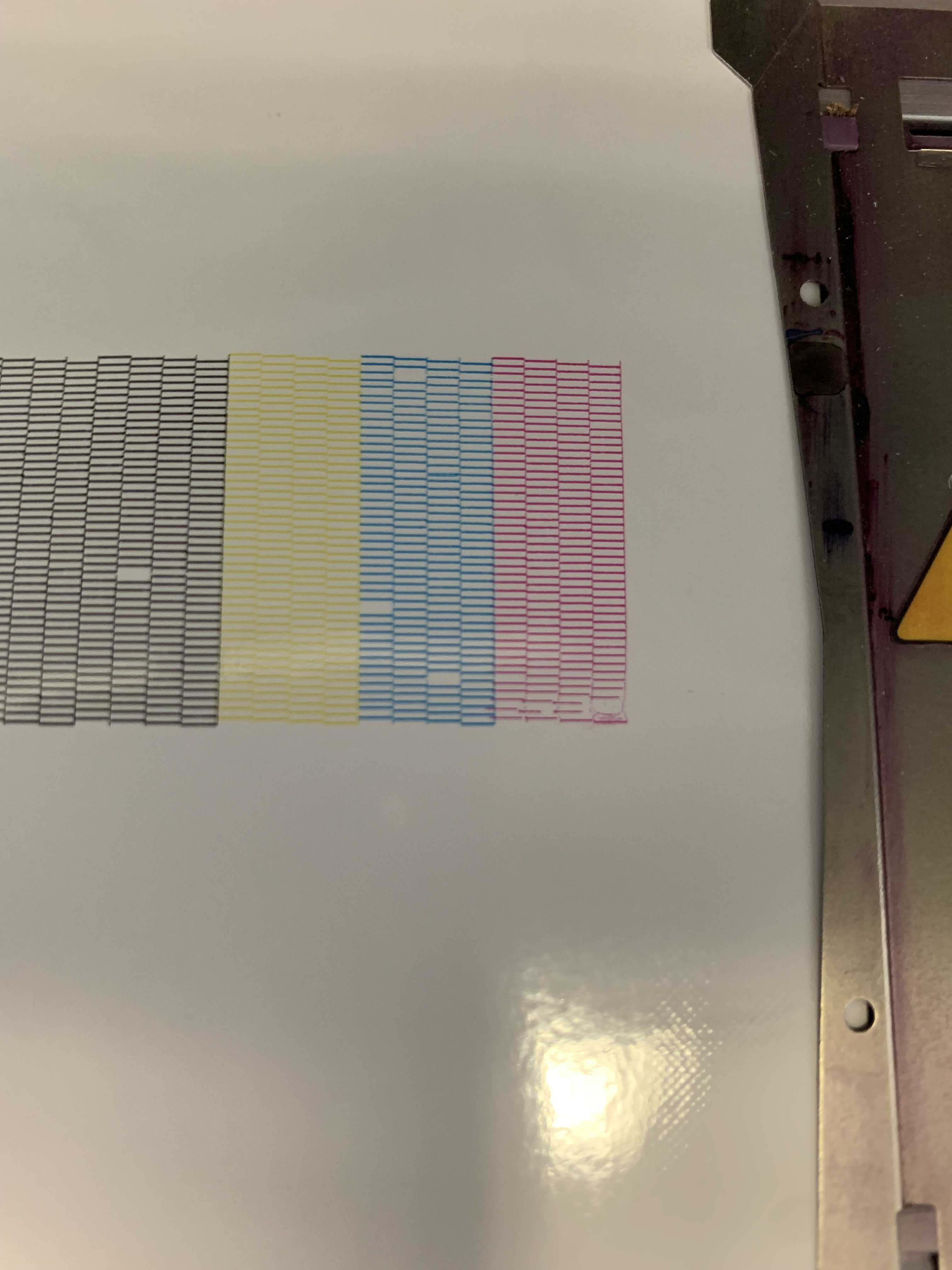

I have had this issue for a while.
The Magenta ink on the right of the head drops out after a few meters of printing.
The test print used to look a lot worse about 20% of the bottom section would be missing.
I have replaced the capping station and pump.
I have replaced the damper.
I will do an overnight soak then all is fine again until I print a few meters then the test print looks like this or worse.
If anyone has any tips it would be greatly appreciated.

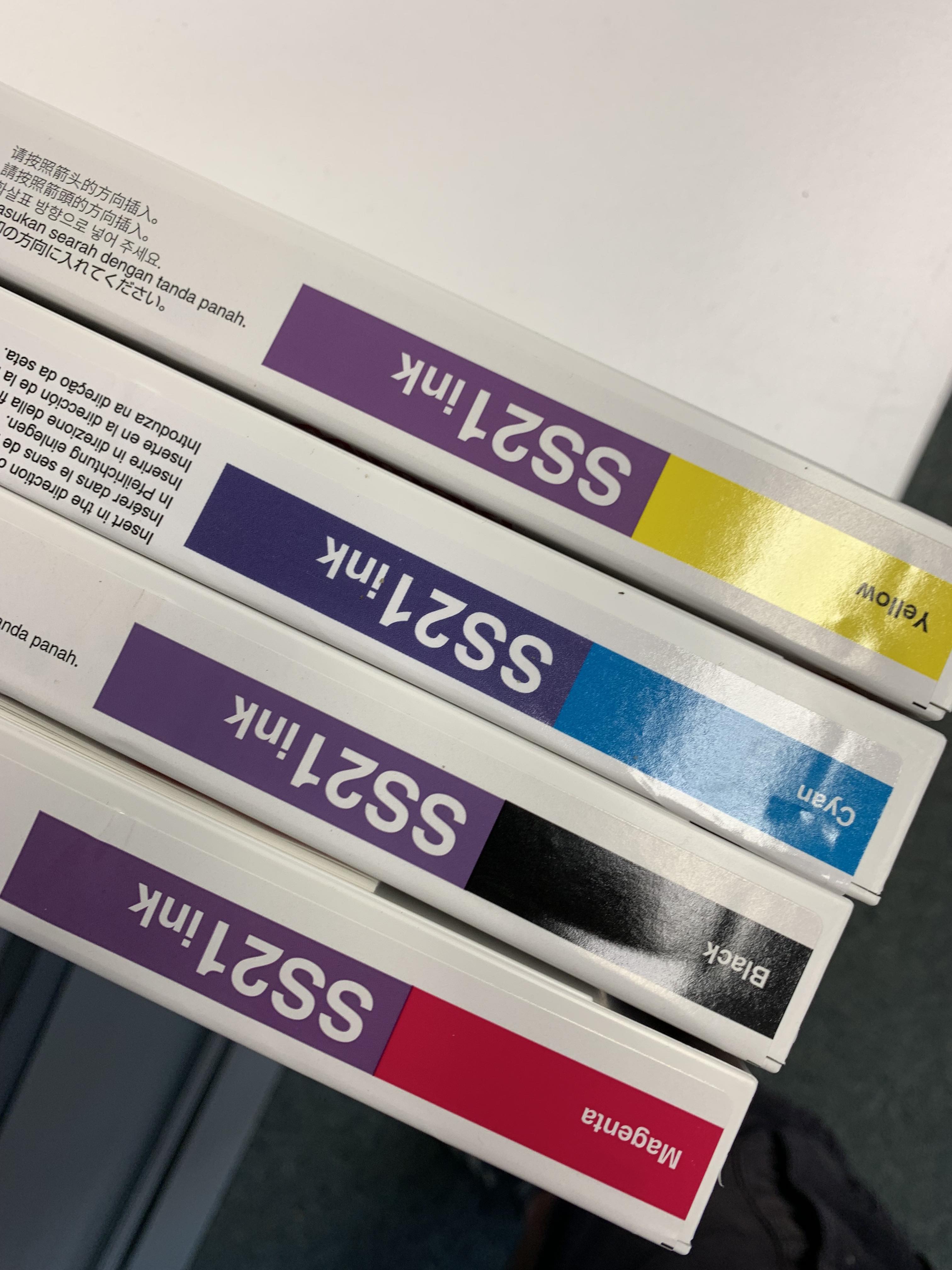

I have only used genuine SS21 inks on this machine. have looked at the cartridges I have and some say 'Made in Taiwan'. One magenta in the machine has it on it.

As Notarealsignguy mentioned, check your carts. If they are all good, check the bottom of the head for any damage or scratches. The warped look of the nozzles on the bottom part of the magenta look like signs of a head strike.

There are very light scratches on the head no real strikes. I did have an issue where the print media would buckle with heat. this did rub on the head but issues didn't happen until later. I have attached images of the cartridges. all say made in Taiwan excluding the cyan.
