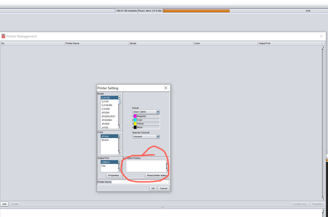

The laptop is connected to the Mimaki downstairs via USB. I have managed to successfully network share the mimaki printer. Please take a look at the first photo I uploaded. This is a screenshot taken from the computer upstairs. It shows that the Mimaki is connected. Now when I open up Rasterlink 6 on the main computer I tried to add the Mimaki as a printer. It didn't receive any signal (see image 2) I went through the Rasterlink connection manual as shown.

Only the new CJV150 Plus model has Ethernet printing capabilities even though your model has an Ethernet port which is stupid I know. In your case though you do have options.
You can get an Ethernet USB hub which will allow you to extend a USB connection from your upstairs computer to the printer downstairs. This would allow you to not have to have a lap top as a middle man. The reason the printer isn't showing up in Rasterlink on your upstairs computer is because it doesn't see networked printers. Only USB ones. The hub will allow you to basically have a USB hub for your upstairs computer extended all the way downstairs without data transmission issues you would normally get with a super long USB cable.
Another way is to create a hot folder on the lap top that is connected to the printer, network the folder, and then set Rasterlink to auto execute. You would need to use the FineCut plug-in on Illustrator or Corel to send jobs to the folder and then Rasterlink would load it up automatically and print. This way is much more clunky and you would need to setup a hot folder for each different profile and settings you want to use. Otherwise you would have to go downstairs and setup the profile and settings and manually hit print which kind of defeats the purpose.
