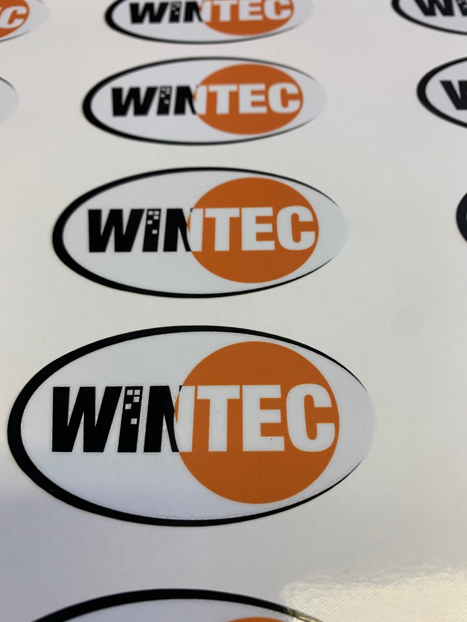

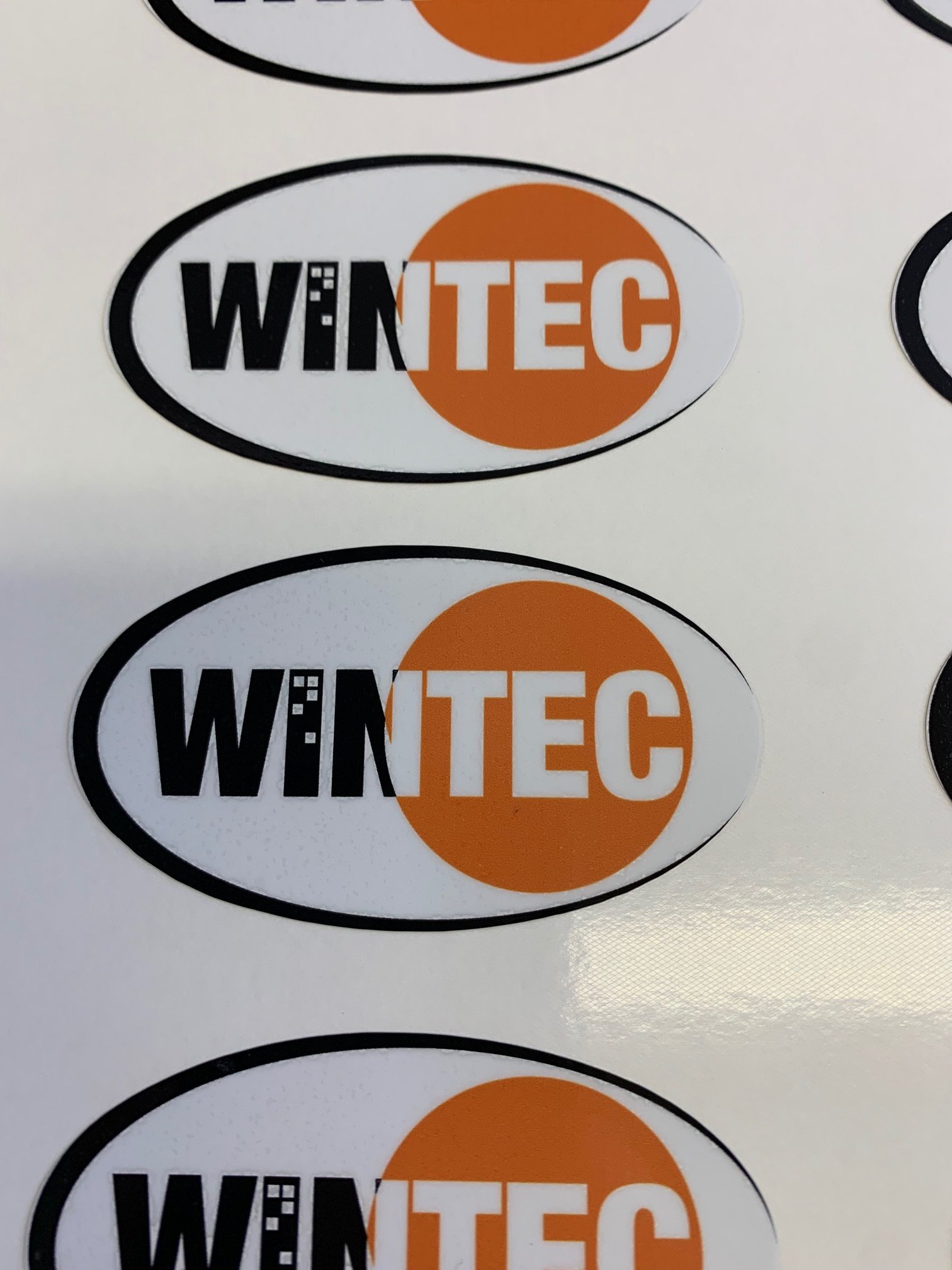

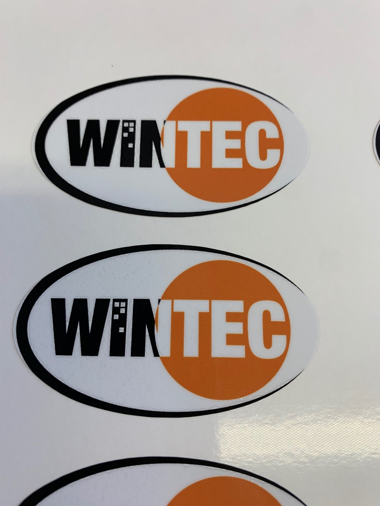

I have a brand new Mimaki CJV150-75. Every time i print then cut, the cutter tracks. Big run of decals 5 feet, small run of decals 1 foot, heat on, heat off, with lam, no lam.

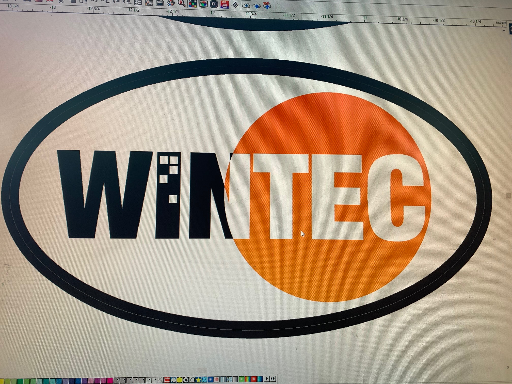

My contour cut is perfect. You can see that in the last pic. Tech should be getting hold of me soon. Very frustrating. Machine is new and only 3 weeks old!

Mimaki is a great machine with the shittiest software ever. I literally had to enter random numbers both in color alignment settings (for all 8 colors !!!!!!) to get a perfect print and one of the cut accuracy number had to be done in a trial and error style without any logic. The good thing is that it can be done if your patience, and I was able to go under 1mm error on a 3m long print with very heavy cut patterns (1/32 inch error on 120 inch print).
