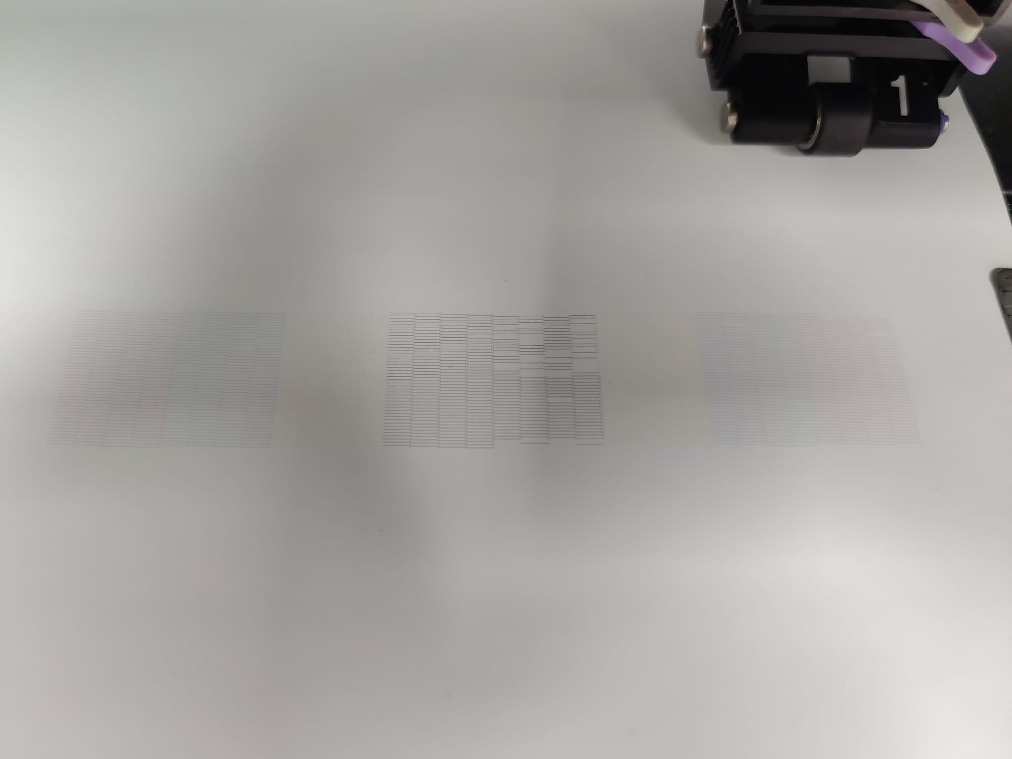

Hey i got my cjv30 since a week but some black nozzle missing already did normal and hard cleaning and a nozzle wash over night any tips ?
SPK

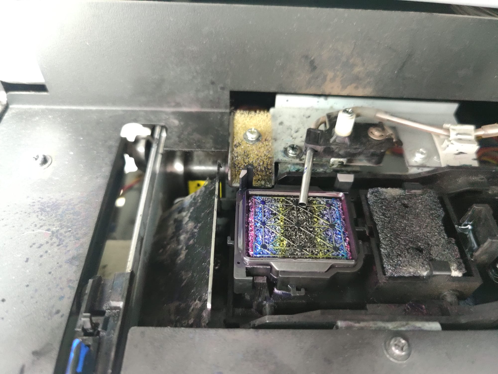

Hey I have changed the cap did an overnight nozzle wash and ink fill after that test print is the same as before any other Tips maybe the pump in the bottom?
Neil
You have to be sure you are getting good suction. Do you see ink pool in the cap when doing a clean cycle?
Is there ink on the wiper blade each time? (That's why you clean it, every time).
Take the bottom cover off and see if you can see ink flow through the 2 tubes. Fill the cap with cleaning fluid and watch what happens when you start it up.
These problems are usually related to not getting enough suction. And that is always below the head.
