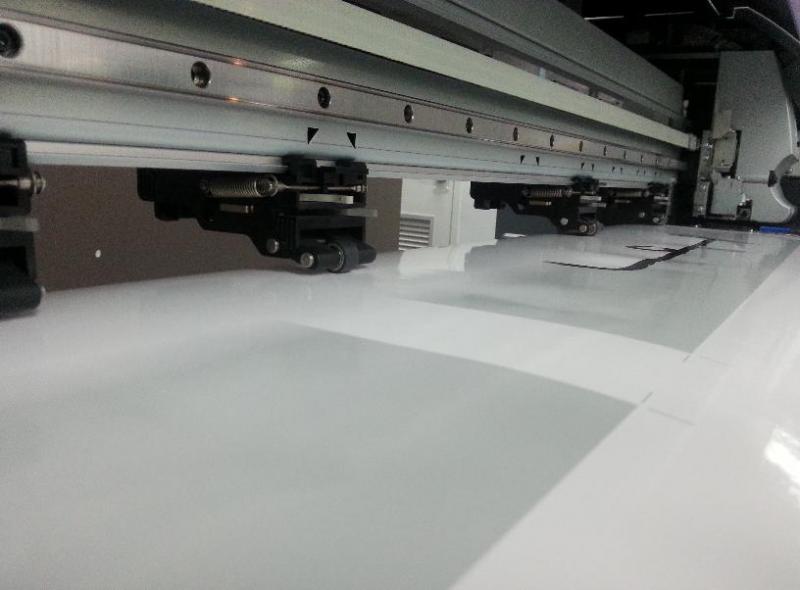

Hi i have a Mimaki cjv30-160 and it prints great and just put a new head in.
But the media is warping just next to the rollers and not printing right.
Iv changed the heater to a few different temps and still not flat.
Iv changed the roller harder and to lighter press still not flat.
Can some one please help
Thanks
Solventinkjet
DIY Printer Fixing Guide
Other than what you have already tried, make sure that the media is perfectly straight before you put the print rollers down. Also you can turn the vacuum up if it isn't on high already.
Here it is in the menu:
Function>Setup>Select Type#>Vacuum>Strong>Enter
