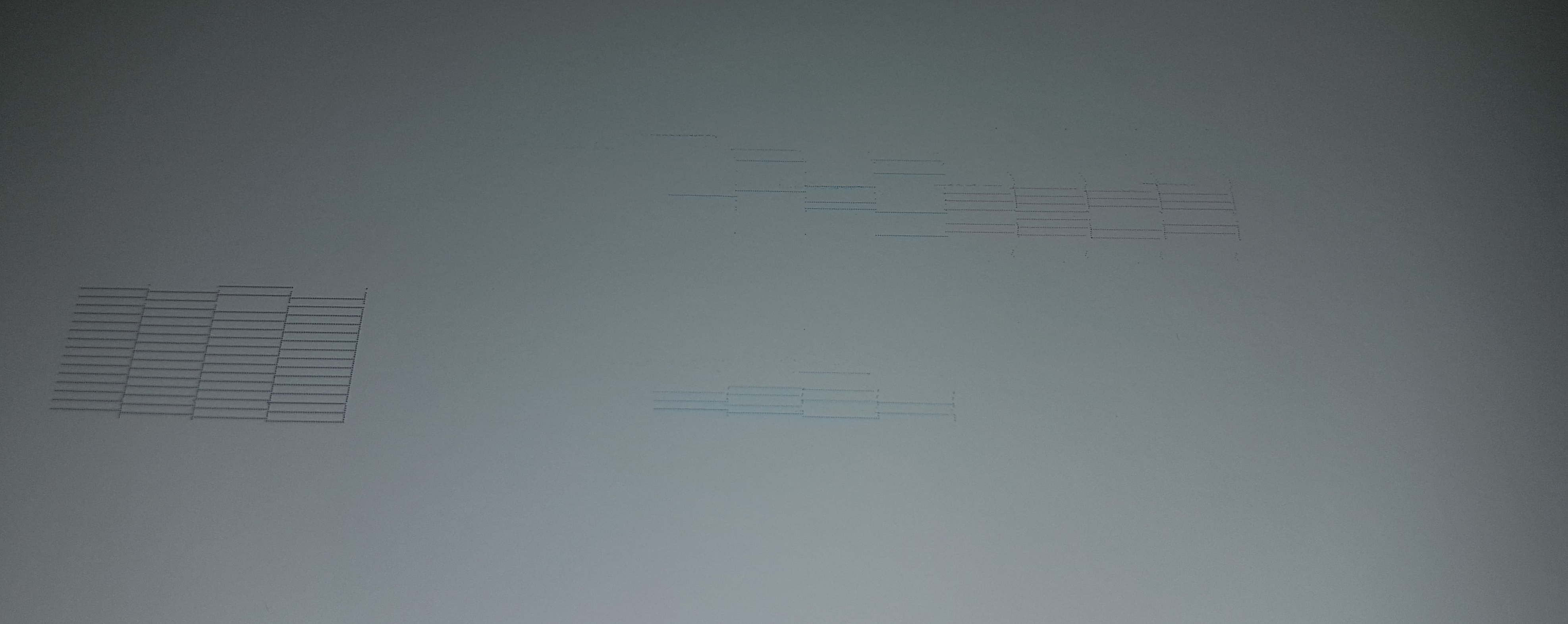

When i try to print test the result its no good, only some lines of black and blue, the rest of color are missing

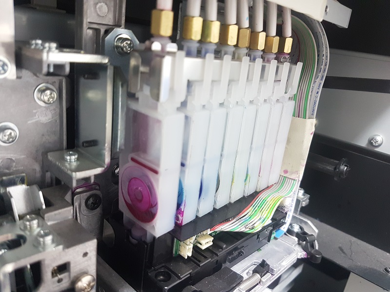

Here is the photos of dumper and pump:

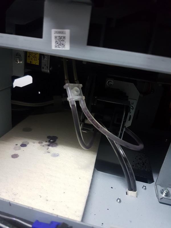

Unhook the tubes from the cap top. Fill a syringe with cleaning solution. Try to push solution through the tubes and into the waste tank. If the fluid makes it to the waste tank, it should be good. If you just get a lot of pressure and no fluid goes through, it's clogged. Usually you can work the clog out by pushing the solution through for a while. Sometimes I will push on one end and pull on the other end with another syringe and that will blow the clog out.

Hi, VanderJ, i fill with a syringe cleaning solution, first get a lot of pressure, but with other syringe vacum tube of waste tank correct?
Now when fill solution in twice cap tubes works perfect, no presure and the solution go to waste tank without any pressure

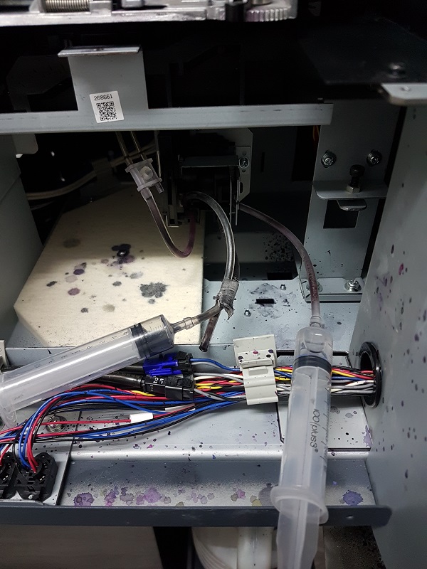

You flushed the pump which is good but now you need to flush the tubes that come from the cap top. A lot of the time the clog is in the little connector that connects the pump tubes and cap top tubes.

Hi, so sorry for delay i need order more cleanning fluid. Today i received cleanning fluid and flush all tubes the cap to pump, always its ok and no prsssure.
Then i have some hard cleaner, but result its the same, i thin the ink no go to the dumpers but i dont know why?

It looks like you have too much air in the dampers.
You need to draw the air out.
Open the cart valves first by hitting Function/Test/Ink Cartridge/Cart Valve.
Press up arrow to open each valve.
Unplug a damper, fix your syringe to the bottom to be able to pull ink through.
Invert the damper so the air pocket is at the top. Draw ink through, till the damper is mostly full of ink and the air is mostly gone.
Do this for all 8 dampers if necessary.
Make sure your cap seal around the head is clean and air tight. One hard clean should bring it back.
