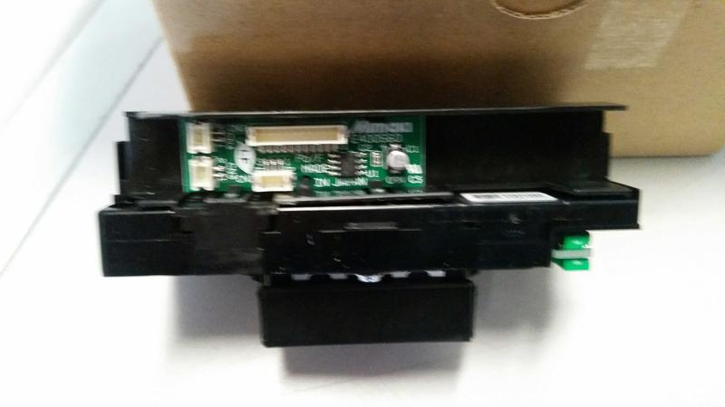

It may be a genuine Epson DX5 head, which the JV33 and CJV30 machines use a modified version of, but it would be misleading to say it is a genuine Mimaki head. A genuine Mimaki head always comes with the memory chip and has the head rank data on it so the head rank sticker and chip head rank should match. Epson has made great efforts to modify their heads so that they only work in the machine they were intended. So even though all DX5 heads are exactly the same internally, they are modified to only work in specific machines by Epson. The head you bought is a DX5 head that does not have the proper modification to be recognized in a Mimaki printer. To get this print head to work in your machine you would most likely have to downgrade your firmware to a very old version for it to recognize it which should have been in the description of the part in my opinion. It's a common issue and digi-print supplies should know better.

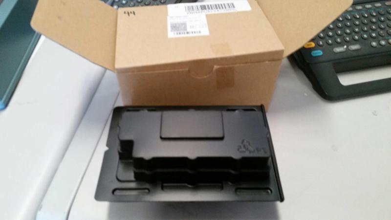

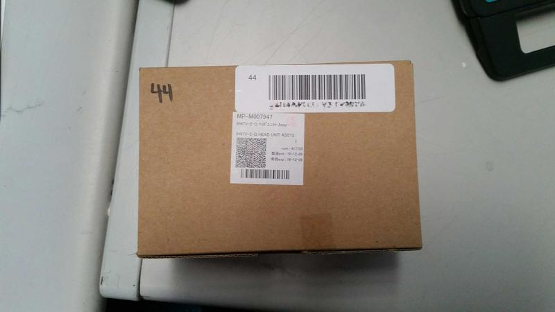

Here are some pictures of how a genuine Mimaki head comes packaged. This is one we had in stock and unopened.
Outer box has sticker with part number and serial number on it
Inner box is a clam-shell type container that actually holds the head
The head it self has the memory boars with Mimaki's logo on it and a black cap on the bottom of the head to protect the nozzles.
If your's didn't have any of these things, it's not from Mimaki.

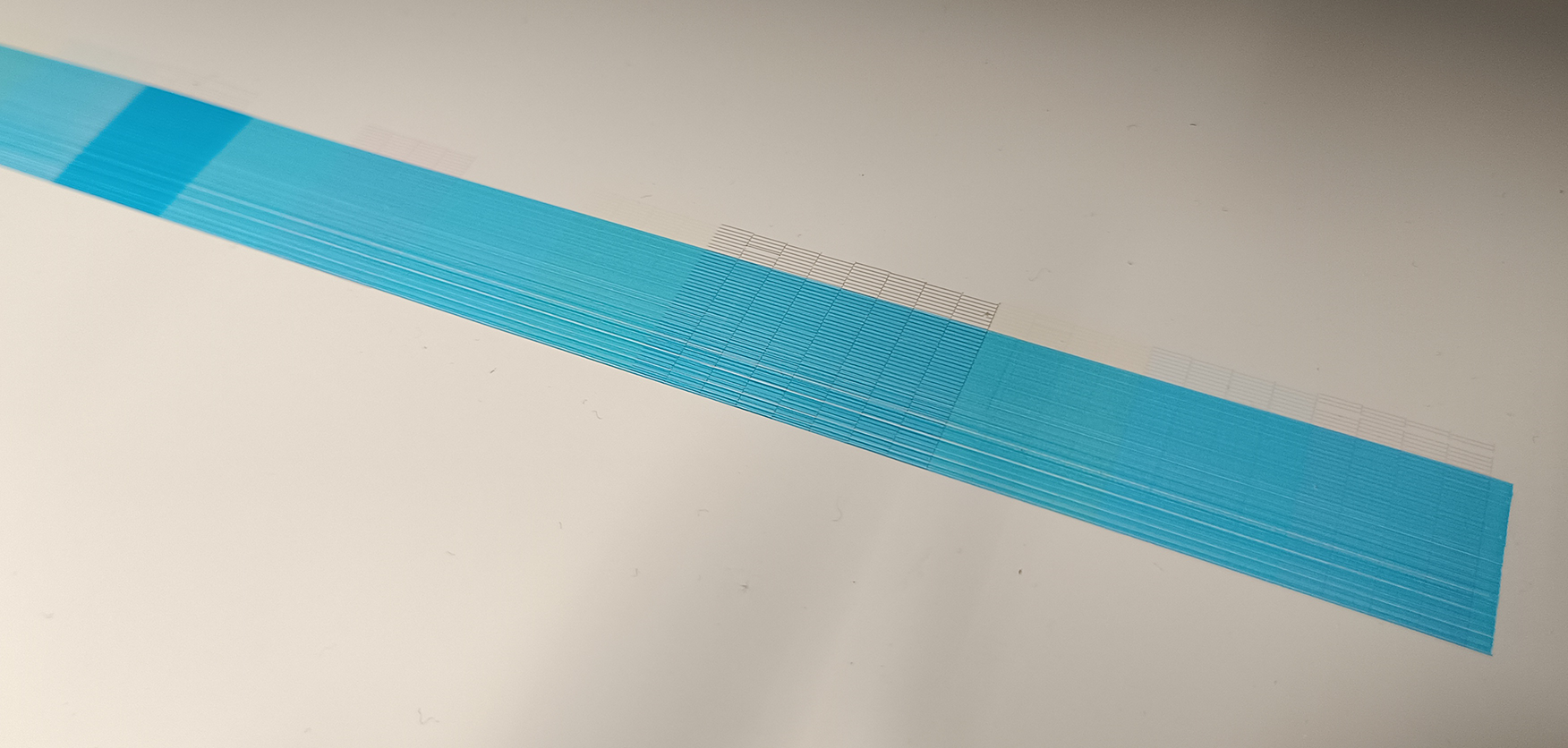

We had the same problem with a Mimaki JV33-160. The error came while the machine was printing. Changed the parameter #76 from 0 to 47, it's printing now, but the left cyan channel nozzles are firing all the time, leaving a cyan overlay on the print. What could be the problem?

Smoke_Jaguar
Man who touches printers inappropriately.
Before changing parameters, make sure your firmware is up to date and can support said changes. Also, BACK UP YOUR PARAMETERS. If you end up with issues, see if changing the parameter back fixes it.
