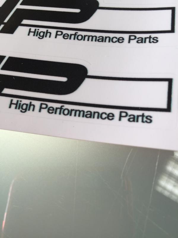

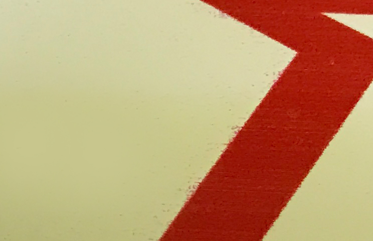

I have a Mimaki CJV30 and just recently it has developed a small strange problem. Attached are some pictures.

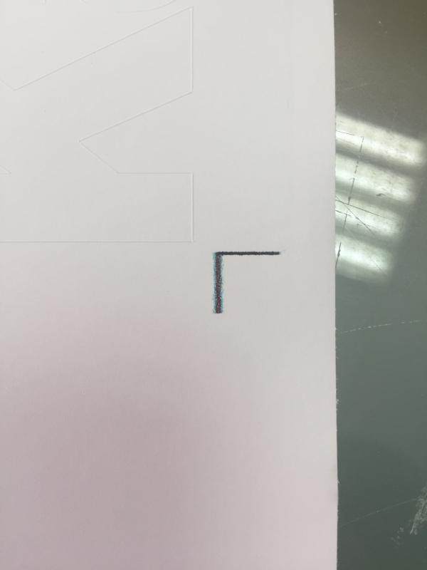

Basically when I print black, there is a cyan overspray. This only happens on black and horizontally, see "L" shape mark to understand what I mean by horizontally.

So when I had this issue with my JV3 it's could be a few issues. One I would look at it being a bad head but I thought that the black and magenta shared a head so than would mean that cyan/yellow might be going bad and needs to be replaced.
Things i would try first:
Daily cleaning of the heads and capping station (do not clean the actual print head but just the 4 sides)
print head alignment
Print head wash cycle as needed.
You should do a print head test to and see what it looks like. This will give you a better idea if the heads going bad or not.

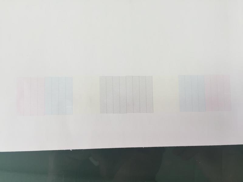

Attached is a picture of the print test.
I do these daily. Just 1 small block of cyan and magenta is missing, this has been like this ever since I can remember, but the overspray problem has just started recently. Could it have something to do with the cold weather?
Or I have read do you think it could need a new capping unit, I haven't changed this part (it's been 2 years)?

Do you clean the capping unit? When operating mine, I found that daily cleaning of the heads and capping unit which included flushing the capping unit would fix most print issues problems. If your heads look good it might be an alignment issue.
