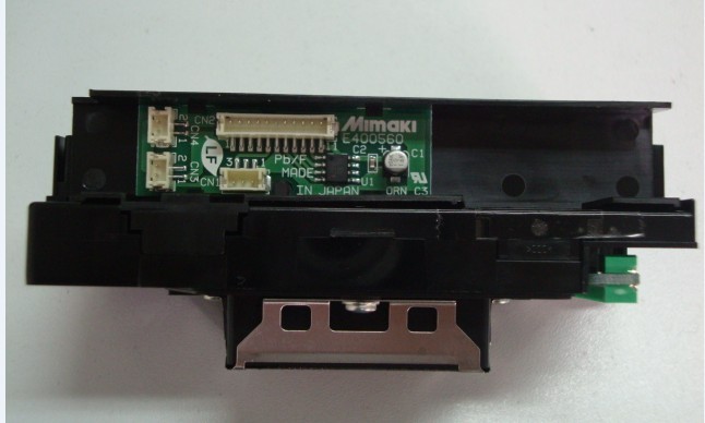

Original JV5 head and original JV33 heads are same, with green cable connector.
There is a memory PCB in JV5, but you did not need change the memory PCB when you change the head. This PCB will keep with printer.
Mimaki JV5 can only use original this JV5/JV33 head with green connector, non compatible head.
Mimaki JV33 can use Epson DX5 head like F186000/F186010.
When you buy a original JV5/JV33 head with green connecter, it is doesn't mater of the firmware. We know these printer and printerheads so well because many of our customers using these printers.
Adam Yang from Inkmed

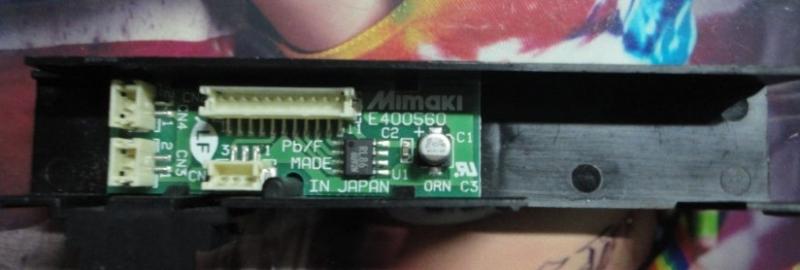

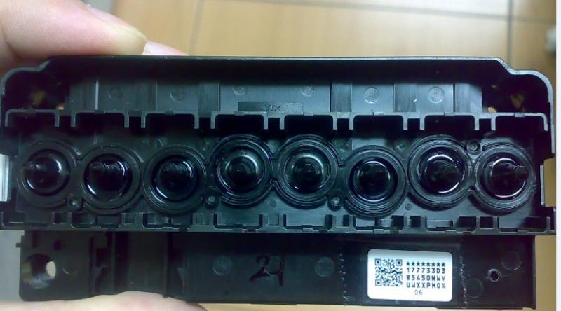

please check the attached pictures. There are spacrate JV5 head pcb and JV5 head without pcb.
when you need new JV5 head, just buy head without pcb, like my picture.
and your current JV5 on printer is same like my picture in my last post, with pcb.
take out the pcb and fit on new head, it is OK.
So, we say the pcb was keep with printer, just change the printer head is Ok. It can save cost.
