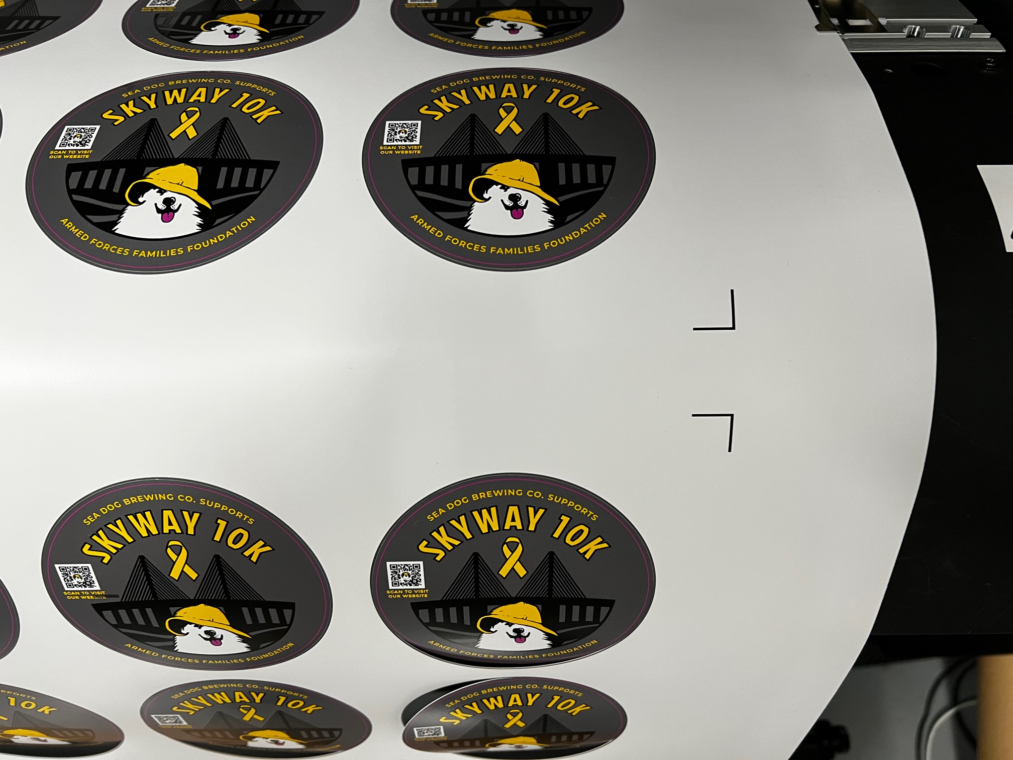

This is a carry over from my last thread.
So, I am printing some stickers in batches and coming to back to cut later (no laminate). So, 4" round stickers at about 5' per batch. When I go to cut I get the first batch to cut it's fine but on the second one it fails to find the mark. It's like the marks are too far apart. It looks for the first one in the next batch but can't find it.
Is there a way to get these marks closer together?

I tried Googling to see if there was a Rasterlink option and couldn't find anything either. On a Summa it would require setting the "recut offset" to whatever distance the regmarks are between jobs, but I just can't find anything about cutting identical jobs in Rasterlink.
I'd be tempted to just print them as individual 4'-5' sheets and power through it. It's not that huge of a job that I'd want to fuss too long, even if there was potential for great time and material savings. Unlaminated you should be making pretty okay money.

This one's been bugging me because I know I've seen it work before so I did some tinkering and I figured it out. What I did was make an Illustrator file the width of my material and how long I was willing to go, stepped and repeated the graphic to fill the area, used FineCut to add the registration marks, sent the file to Rasterlink using the FineCut send to Rasterlink button, and once it was in Rasterlink I could make copies of that file, print, remove the vinyl, re-load, set the mark sensor, and then send the cut only job from Rasterlink. It worked perfectly. It's more work but might be worth it on larger jobs.
I also called Mimaki and asked if it's possible to do it the Execution method I mentioned above but they said no so not sure where I picked that up. Hope that helps!

That's way over my head. Rasterlink will do the crop mark search in multiples, the problem is the spacing between prints is a little too much and it doesn't catch it. Mine did it 1 time, not sure how but I forgot to change execution to 1 on the cut (like always) and it cut twice. I'd bet there's a way, I just don't know what it is.

I think I can see how this might work. Set up the file in AI with an art board the width of the media and the length you want to print, repeat the art to fill the artboard, send to rasterlink, set the mark to individual instead of whole, print multiple copies, come back and cut?
You have to add the crop marks in Illustrator using FineCut. Otherwise it won't let you have two groups surrounded by crop marks. So exactly like you said except you just need to add the crop marks in Illustrator.

Notarealsignguy This worked for me.
1) Create an art board in illustrator the size you want to print. Say, 54" w x 36"h.
2) Duplicate your image to fill the art board.
3) Create your marks in AI using Finecut
4) Send to Rasterlink
5) Print as many copies that you need. Lets say 6.
6) Laminate
7) Put back in the machine and find your first mark.
8 ) When you go to cut, do not increase the copy amount. Go to the Execution tab and set the amount of times you want it to execute the cut. 6 in this case. So one copy of the cut, executed 6 number of times.
When printing I set the feed space to .25" so the marks are closer together. Presto!
