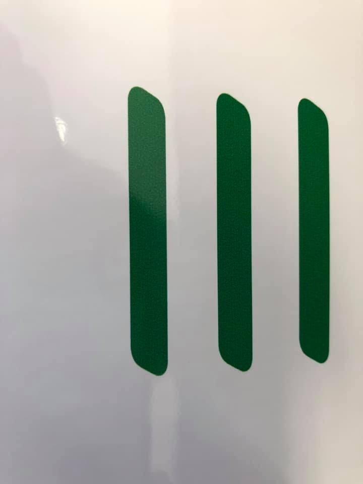

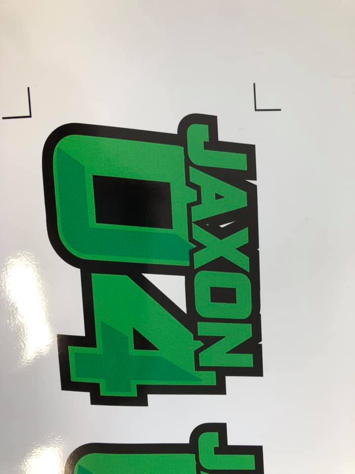

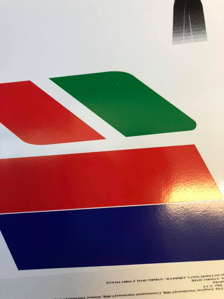

Hi,
Is it normal for certain colours too look slightly grainy like this. Machine is 2 year old running cmyk x2 the engineer who installed it said it’s normal on certain colours. If we print a cmyk pattern the colours are solid with no banding.
We run prints on 1440 with 16 pass any lower the grainy prints are far worse. The machine is a CJV150. We only use the orajet 3164 profile as its the only one the prints with a lot less graininess. The mimaki GPVC one has better colours but looks a lot more grainy. Are we printing on too low settings or should we be able to run a lower pass rate with less grain?

I found that happened on certain medias... try playing with temperature and the number of passes, if I recall right we saw that decrease at 32 pass and a high temperature.

Looks normal to me? 32 pass, you could take a nap waiting for that thing to finish printing a bumper sticker.
Thanks for this, We have run the machine for a couple of years like it and have always been happy with the quality. I just wasn't sure how solid the print should be. A lot of the colours are solid but some colours like orange and green are slightly grainy. I assumed it was the nature of cmyk printing. I think I will stick to 16 pass unless I'm feeling lazy and want a nap.

If the prints are much less grainy when you print uni-directional, then perform a ‘drop-Pos’ alignment. It is in the Setup section.
7_nebo_7
Try to print in uni-direction and check result. For me it looks too much ink on the material. Also it may related to particular media then you have to look in to temperature and color profiles. Also make sure all calibrations are done correctly.

The prints look fairly normal to me but I can assure you that media is a huge factor. I had a customer running 3M with ok-ish result.
After running every possible adjustment to make sure the printer was not the issue, we used Arlon and the same print was flawless.
You can try changing the heater's temperature but to me media is the answer.
