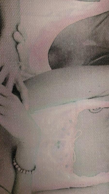

Hello I am trying to print some grayscale images and there seems to be a cyan or oink drift left behind on all white areas of the image. What might cause this?

Bad or incorrect ICC profile being applied by rip during color conversion. Also can be from improper media selection, intensified by a media that's overly sensitive to those inks. Profile the media properly.
