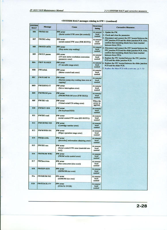

I'm having a problem with my printer. I keep getting a (system halt Error 811:FW/SIO read) Can anyone HELP me out
Brink
Page 2-28 of the maintenance manual lists this error.
Here is the page of the manual:

I have a manual but I up graded the FW to 2.7 but in the book it says to up grade the Sub FW. Where can i get that
Brink
I can't find any help for you on firmware or sub-firmware. Where did you get the upgrade? Can they help you? Otherwise I would contact Mimaki.
