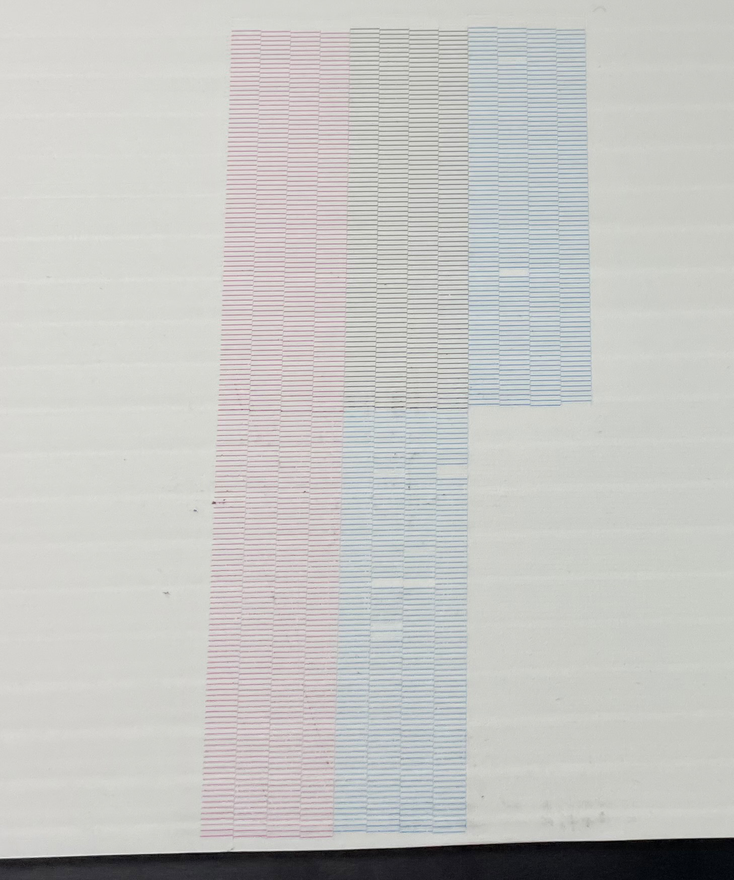

Hello, all: Last Oct, Our Mimaki Jfx200-2513 printer suddenly printed out abnormal color during printing. After doing test printing, it shows that entire yellow ink is missed (see attached image). After doing heavy clearing, a little yellow ink came out. We did something else, adjust pressure, air purge (no yellow ink discharge) without any improvement. The printer has no any error message and print-out other color are fine. We have replaced new wipe, primary filter and tube pump. The problem still exist. One day of Nov, the printer room's temperature was very high, The print-out yellow ink came out as normally. Last week, the same problem of yellow ink happened again. I guess that one printer parts was affected by room's temperature. I have checked subtank and found less yellow ink in it. The Appreciate it for any kind assistance!

When you do a cleaning do you see yellow ink in the cap? Check capping position (seal). I bet it's more than likely a bad sub tank/sensor.

First replace both caps, capsule filters at least on yellow, ink pump at least yellow, and do soakings few times a day until recovered, if no improvement only printhead replacement will help
