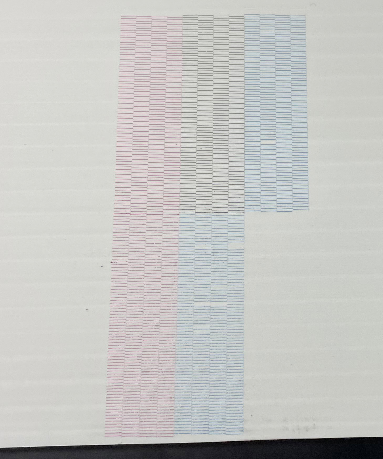

Hi, All: Our Mimaki Jfx200-2513 printer suddenly printed out abnormal color during printing. After doing test printing, it shows that entire yellow ink is missed (see attached image). After doing heavy clearing, a little yellow ink came out. We did something else, adjust pressure, air purge (no yellow ink discharge) without any improvement. The printer has no any error message and print-out other color are fine. We have replaced new wipe, primary filter and tube pump. The problem still exist. Appreciate it for any kind assistance!

If I remember correctly, the JFX200 has 3 Gen5 heads. Is yellow missing on all heads, or just one? If just 1, it might be a subtank issue, if all 3, clogs, ink valve or similar issues might be to blame.
micadesign
jfx200-2513 as only 2 gen5 heads.
but yes, he should change de subtank and/or the ink valve....

Thank you all for taking a time to reply me. Basically the printer is working fine except yellow color in last two weeks. One day the error of "supply ink: Y" showed up. After we executed the function of "Sub tank" Refill. The yellow nozzle of the test print went back to normal. But the right state only last after getting done one printing job -- yellow ink dropped off suddenly again. I guess that little of yellow ink left in subtank. We never replace subtank ourselves. Is it hard to change a new subtank?

It looks like one parts affects from temperature of printer room. frozen weather resulted to yellow ink stop somewhere. Yesterday printer room was pretty warm or hot. Print-out yellow ink came back to normal. and also we checked the subtank and found that yellow ink is full or a right level. The subtank seems to have no issue. Someone suggests that we should replace all of circulation filters. I am not sure if this is a right direction.
