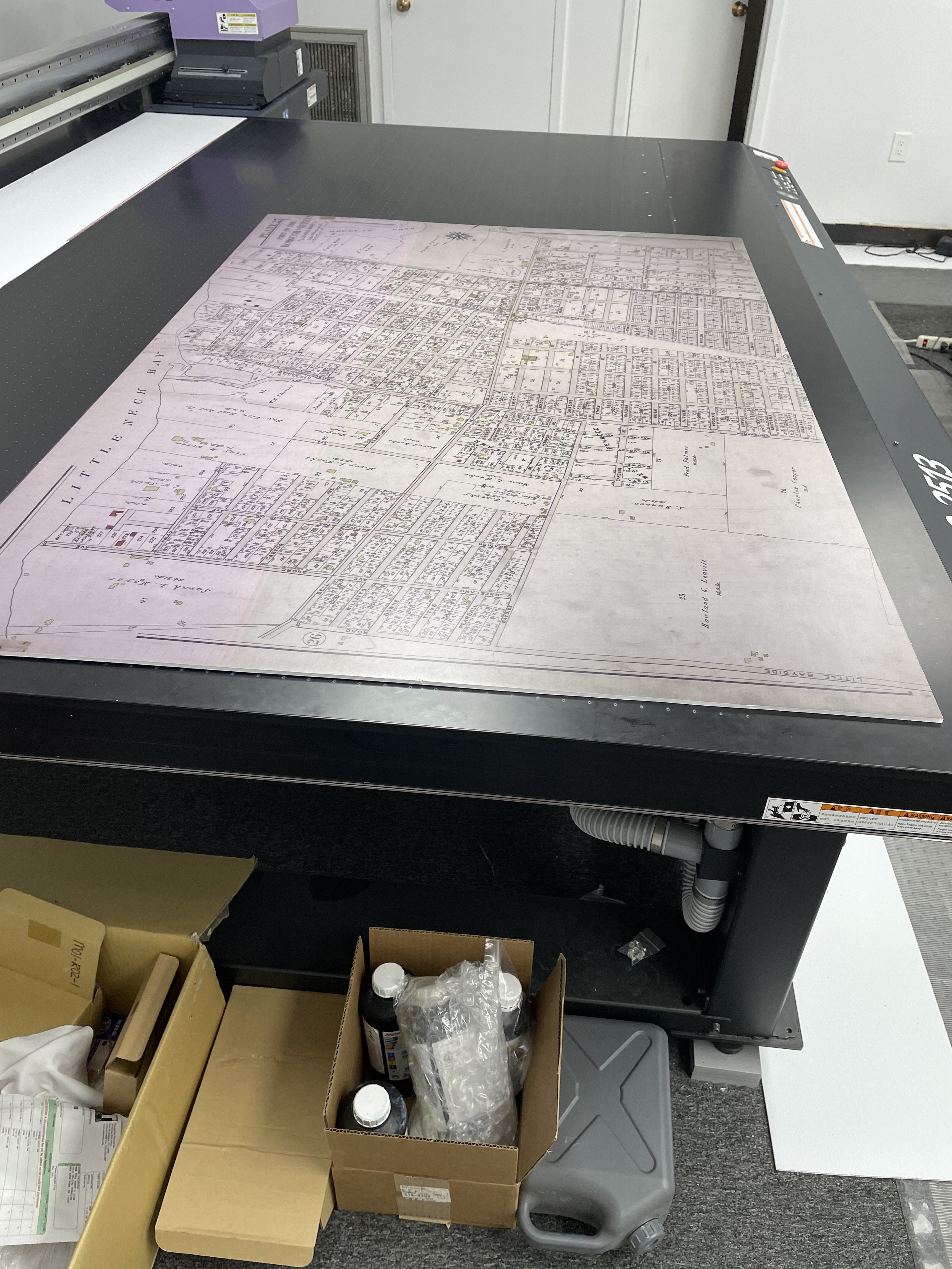

Every time, our Mimaki JFX200-2513 printer prints big sheet, such as 4ftx8ft, after printing the correct color for a while, incorrect or extra red color stripe shows up (see attached picture). how to fix up the problem? Thank you for your kind assistance.

In my opinion, since the color drops and doesn't come back, it appears to be an ink starvation issue. Is there any ink left in the sub tank when this happens?

I agree. It looks like ink starvation during the print. In these cases I usually check the positive and negative pressure, adjust if needed, and then run an air purge. That takes care of a lot of ink flow issues that aren't caused by a broken part.

thank so much for answering my question. We did adjust positive & negative pressure and air purge. and also print test result is good. it seems that there is no problem except printing yellow color--"yellow ink starvation"? I have just check how much yellow ink left in the bottle. still have 5-6% yellow ink remaining. do we have to replace new bottle of yellow ink?
