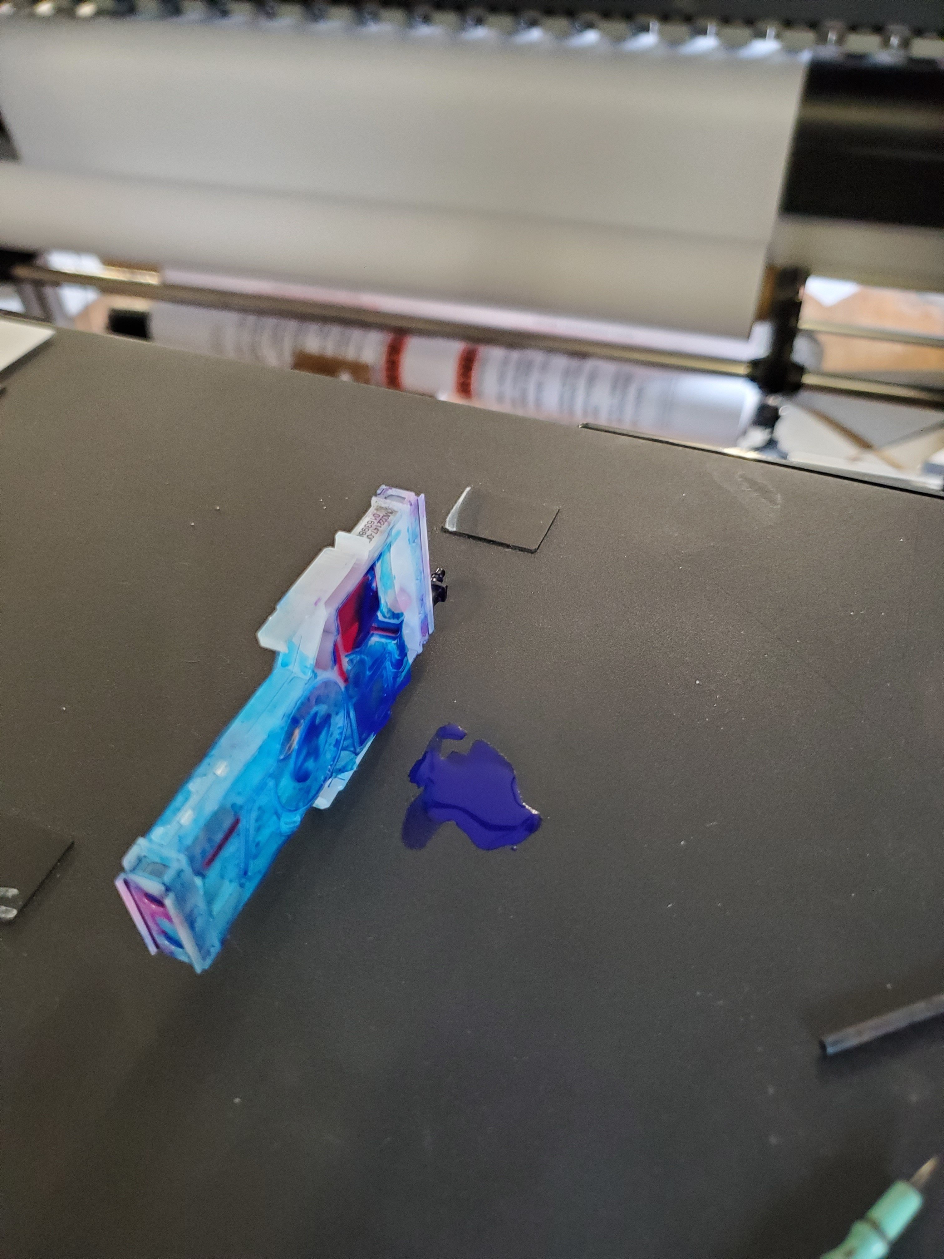

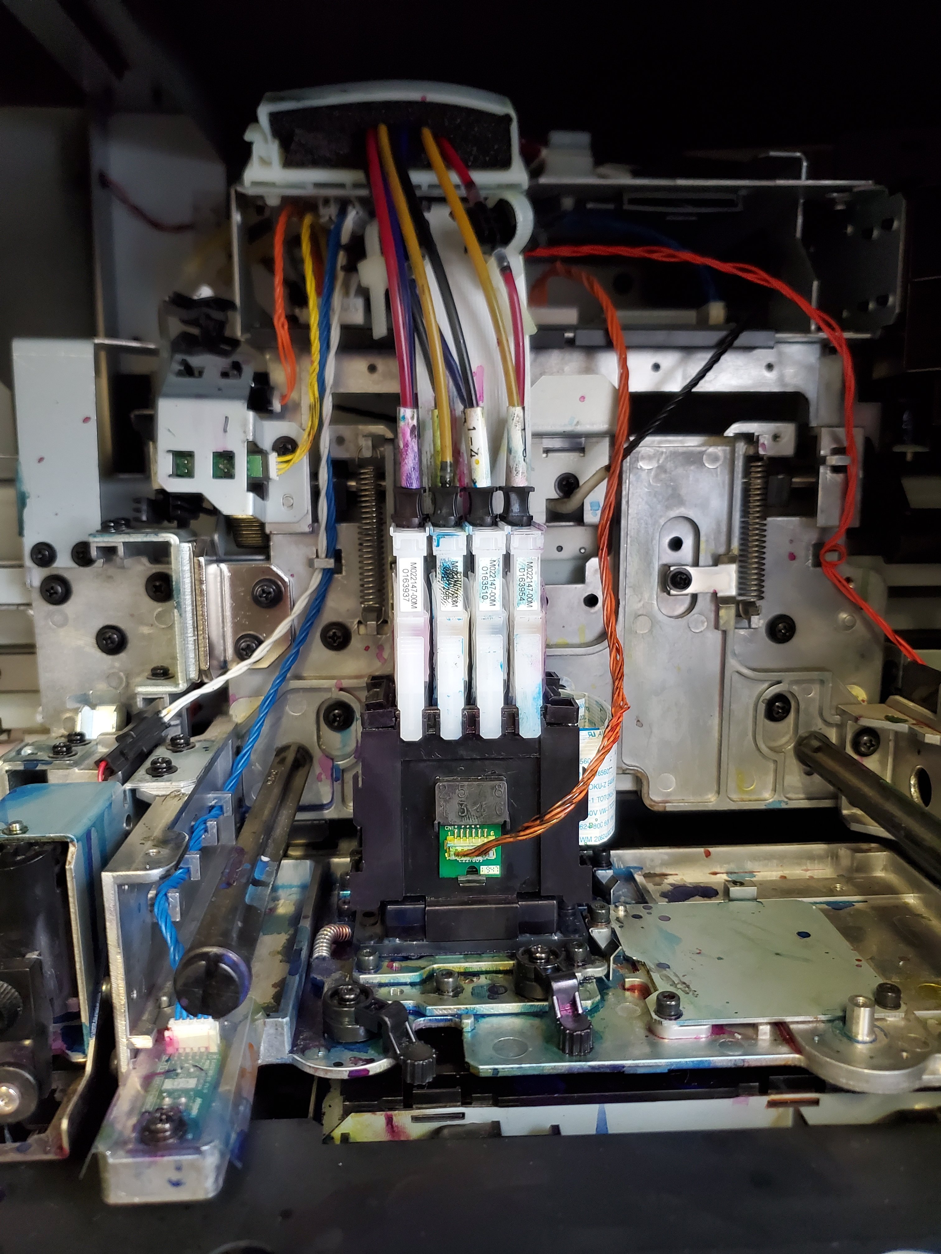

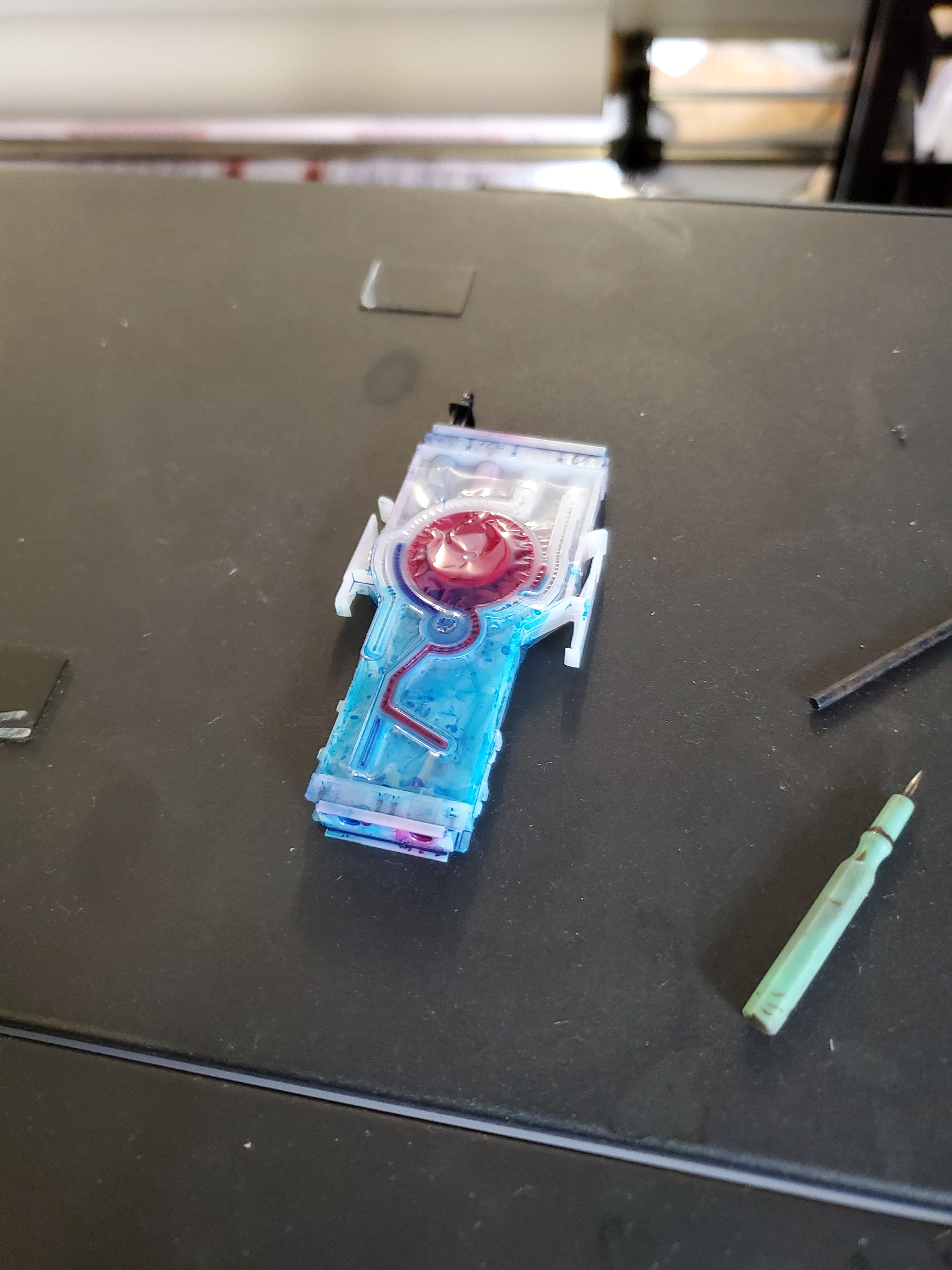

Has anyone else with a Mimaki printer had a "new" damper failure that resulted in ink leaking from what appears to be delamination of the clear material that covers the side of the damper? The damper did not leak from either the top where the ink line comes into the damper or from the bottom where the damper secures to the head. I have a video that clearly shows the ink running out of the side of the clear plastic. I can post photos or a video if needed. This occurred on a used CJV150-130 printer that I recently purchased for use in my business. I have three Mimaki JV33's and one ten foot JV5 that I have personally done all the maintenance and repairs on for the past 10 to 15 years. I have replaced dozens of printheads and hundreds of dampers. Unfortunately I have gotten to be pretty good around these printers. I have never experienced a damper that leaked such as this one. I had just installed the new head with four new OEM dampers and a new cap. The process went well. I primed the head with ink (Triangle) using a syringe above the ink pump. Had good resistance drawing the ink. Nothing unusual. Test draw was excellent. Changed the head id#'s, did the alignments and sent a 10 or so foot banner. Printer was running well. Sent another 10 or so foot banner. Came back to find the printer had stopped. Got a message something about "stopping job due to insufficient nozzles". I glanced down at the printhead and saw cyan ink oozing out from under and around the head. Knowing what ink can do to circuit boards, I immediately powered off the printer. Unfortunately this event shorted the head, slider and I am almost certain the main board as well. I mention in the post that I purchased the parts from Digiprint. This is not to suggest that I feel they are responsible or have done anything wrong. Actually I have purchased many heads and other printer parts from them. They have been very good. They have a former Mimaki technician on staff to help advise when a customer needs. This is a convenient service.
Mimaki on the other hand is unwilling to accept any responsibility at least at this point. Hopefully they come around. They are indicating that because I am not a licensed Mimaki Technician and am using Non OEM inks in the printer, they cannot help. It seems to me that neither of these points have any relevance to an OEM damper leaking. If there are others out there who have experienced a similar issue, I would be interested in hearing about their experience.
My suggestion to others replacing dampers on CJV or JV 150's or 300's, check in on these dampers for dripping ink after the initial installation of the damper. Obviously it is important to get the ink line into the top of the damper properly as well as making certain that the damper bottom clicks into place fully. Not doing these properly can result in leaking ink. However, having the damper leak from the side is totally unexpected and difficult to identify without taking it off the head. This makes it very difficult to figure out it is leaking until the damage has already been done to the tune of thousands of dollars.

I've been working on machines for about 15 years and I've never seen a brand new damper leak like that other than if it had obvious physical damage. It's possible it was damaged in shipping or something I'm guessing.
Also, just a note, if you had to input the head rank number, the head was most likely not an original Mimaki head. That's not to say the head is wrong. At the end of the day it's an Epson DX7 head. But an original Mimaki head will come with the head memory board and will automatically update the head rank when installed. If the head didn't come with the head memory board you know for sure it wasn't original. If it did come with a board and you still had to input the rank number, it's not original. The original head also comes with new cables that have a plastic shield that protects the cables form ink splatter. The fact that your memory chip has a fair amount of ink on it and the head is missing the plastic shield tells me you were sold a non-original head.
The dampers do look OEM though so they should be able to put in a 90 day parts warranty with Mimaki and at least get you a new damper.

Thanks for your response. Actually the head is a DX6 not a DX7. All my previous experience is with DX5 heads. In any event, I am confident that you are correct about the head not being OEM. I used the memory board off the old printhead thus had to put in the new head ID. I do have the plastic shield that protects the cables which will go back on once this is finally running.
As for why the damper leaked , I am truly uncertain. Since they come individually boxed and wrapped in plastic, it would have been very obvious if this had occurred in shipping. It did not. I spoke with the former Mimaki Technician at Digiprint who indicated he had only seen this occur once before on a printer that he repaired with similar results. He suggested that I was very unlucky. I am new to working on this newer style JV150. Though inserting dampers into the head seems much better in terms of ultimately maintaining good vacuum, they do not slide in as easily as one might expect. Could I have damaged the damper during install? I really do not see how. In fact, the way the dampers go into the DX6 housing, assuming you get them fully clicked into place, is much improved over the DX5 both in terms of reduced chance of cracking nipples and improved ability to maintain vacuum. The lack of brass fittings with small "o" rings seems a vast improvement (assuming they all click into place) which I suspect reduces the chance for loss of vacuum and increases the longevity of the life of the head and quality of the print. Overall, from what I can see, Mimaki improved an already good print platform.

That really stinks. However (and I've done my own work for 20 years as well on JV3, JV33, and now JV150) one thing I've always known doing the repairs myself.... 100% of the risk is on me as anything that goes wrong can always be blamed on me and I have no recourse. I save a TON of money though. I could spend a ton, then if something goes wrong, any blame (and the cost to rectify it) falls on someone else. Pretty much how its always been in the DIY repair industry. Same with auto parts and fixing your own car - get a bad alternator and it fries your PCM, BCM, stereo, etc... the parts store is only going to replace the faulty alternator they sold you, tough luck on the other parts it fried. In nearly all industries, including even the vinyl we print on, if the item proves defective, the limitation of the manufacturers liability is they will replace the defective item, nothing more (and usually spelled out direct or indirectly caused). I've directly run into this with vinyl - Avery, 3M, etc are not going to compensate for the loss of time, additionak ink to reprint, reprint time, removal, reinstall, irritated customer, etc. They will send you a replacement roll.
That being said - I've also never seen that on an OEM damper but I have had pinhole leaks in generic dampers (which is why I will never use them anymore). What strikes me as off though is even when I had discovered leaks in dampers before, ink does not leak out, it sucks air in. This part of the ink system is negative pressure and under vacuum so for ink to leak out of a damper, it would have to be a pretty big leak.
