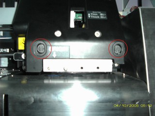

An I have another question what these screws do?

Loosen the screws, raise the head height lever to thick (actually, that's push it down), while you're holding the lever down retighten the screws. Don't tighten them freakishly tight, they're just plastic and will strip out easily, just tight enough to hold it in place. IF you don't loosen the screws, the head will not raise or lower, they are what holds it in place.
