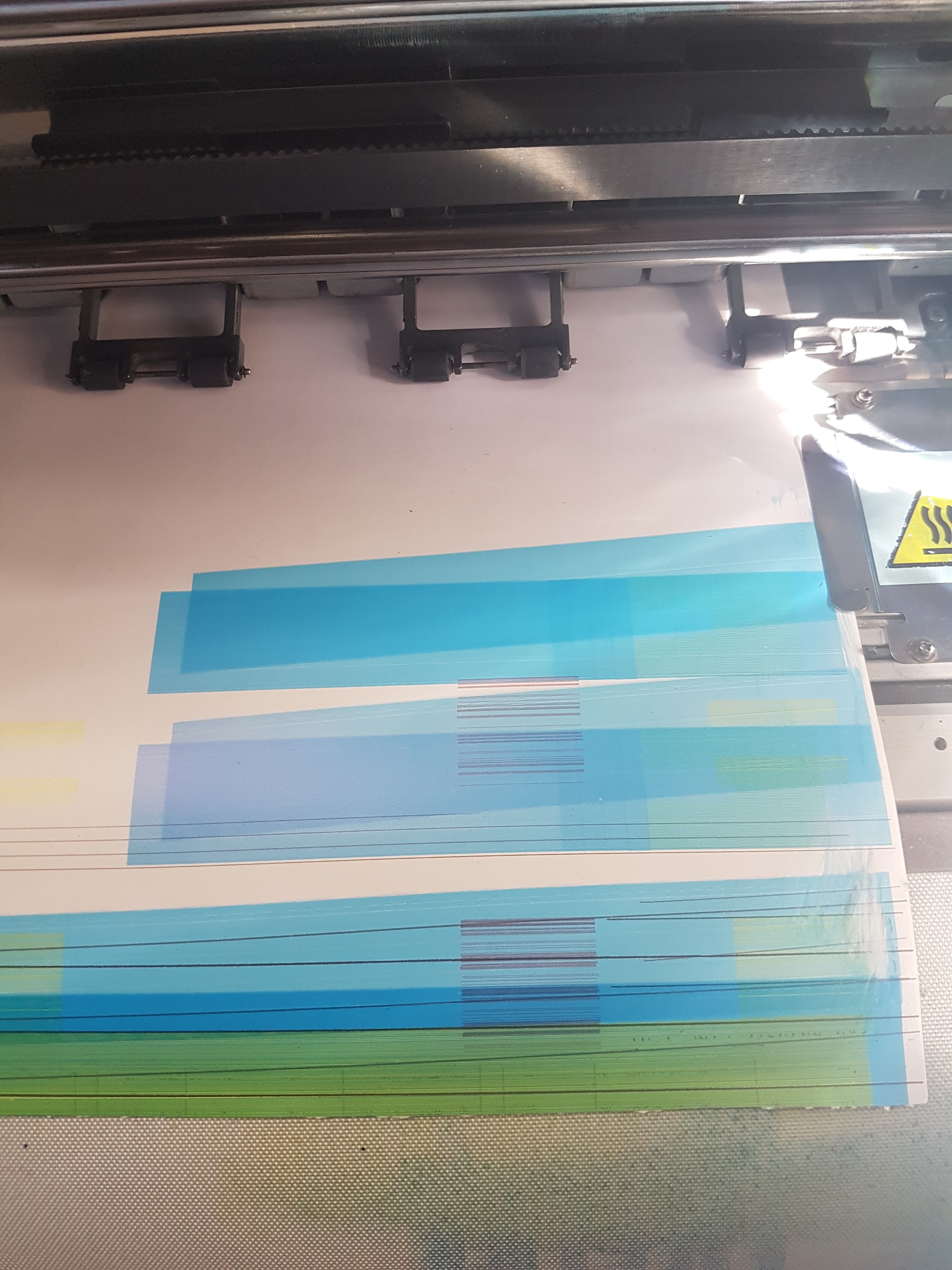

Hi again folks.
I'm tinkering with a jv3 160sp and got the electronics sorted out and was on my way to getting the heads unclogged and all of a sudden during a pattern test it starts dumping out the cyan like mad, from the moment it leaves the capping station till it returns to park its a steady blue band. It also stopped shooting any other colours now as well. (on the plus side it looks like it cleared all the cyan nozzles in the process)
Anyone ever see something like that?
Tom.
Tom S
Ok this is really odd. I even swapped both cables with the magenta head and it still prints only cyan..
FML
Tom.

GTSTech_1
I'm afraid you haven't solved your electrical problem just yet. That output is being caused by either Head cable not seated fully at the printhead or where the head cable connects to the slider board, or the Slider board itself has gone bad.
Just my .02
Tom S
I pulled the slider board off and went through all the cables and made sure the connections are clean and well seated, so far no sign of anything that could cause this. Slider board physically looks good, its clean no hot spots. Fets on it tested out good. I'm about to put the slider board back on, not feeling too hopeful.
If I can remember correctly it started right after a strong clean cycle.
Whats got me mostly stumped is even when attached to the magenta port, the cyan is the only head laying ink down.
I hope its not a head gone bad.

MikePro
keep the printheads where they are, isolate where the issue comes from by swapping ribbon cables to see if the issue follows. if the issue stays with the printhead, then its the head. if the band continues through another channel then you know the issue is above the printhead (creased ribbon cable, connection to slider board, or encoder issues)
edited after noticing you installed old printheads & the blue band disappeared after doing-so: chances are that you have some ink that dripped down the ribbon cable and into the connection. you can clean this by wetting some index card stock with cleaning solution and inserting/removing clean pieces a few times, and then finish by repeating a few times with dry card stock to remove any remaining moisture.
Tom S
I had some heads that were totally dead and stopping the machine from even going through the printing motions after the cyan died so i needed to be sure it didnt fry the main board.
once I did that i wanted to be sure the lines were not dried up so i flushed the one working head a bit and flipped it from channel to channel. All channels and ink lines are working well so its strictly a head issue.
I did clean and freshen up the leading edge of all the cables and cleaned the sockets before posting here, no change in operation. I did more searching and found a forum post that showed the same issue and it was determined the head was bad so i just trashed it.
