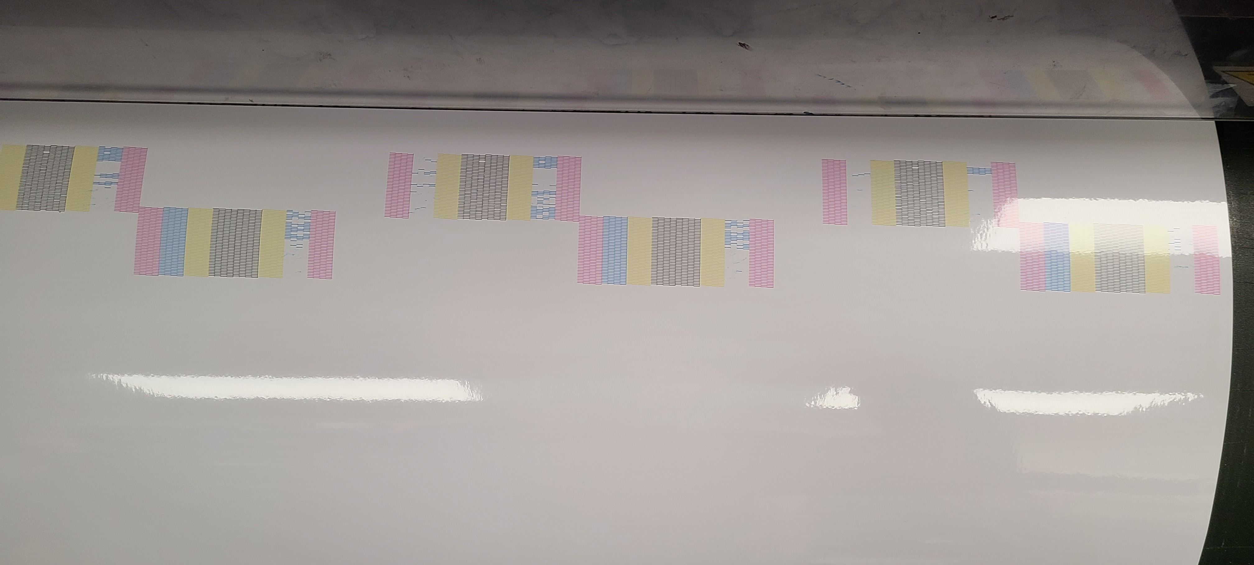

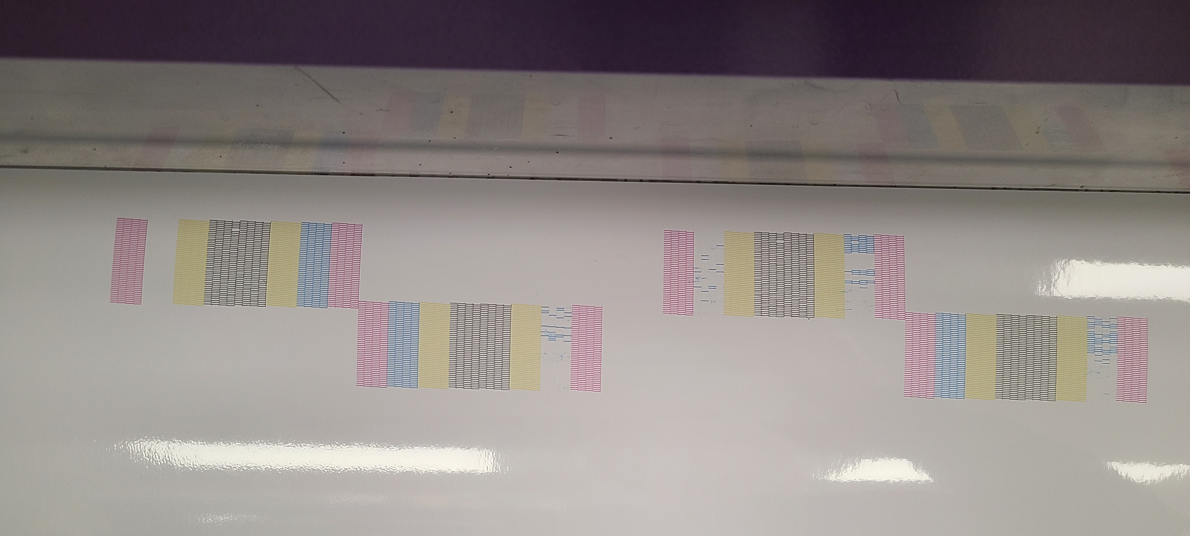

My printer nozzles are always clogged. In particular, the Cyan. Head 1 the left cyan is almost never existent. Ive done nozzle washes, I've let the nozzles soak overnight with the shut off technique, I've done countless cleanings of all intensity levels.
After I do that the head 2 right Cyan always seems to be fussy for a few washes until it usually all comes back.
I have no idea how to use the Nozzle recovery. I don't quite understand. I have watched videos on it, but they're all missing not just 1 or 2. A new head is like 3000 at least and I doubt they will want to pay that, especially if it's something I can fix on my own.
First picture from RIGHT to LEFT is after an over night soak and then the test prints after a soft, normal, hard cleaning. The 2nd picture Right to Left is a Ultra and then a Soft cleaning.

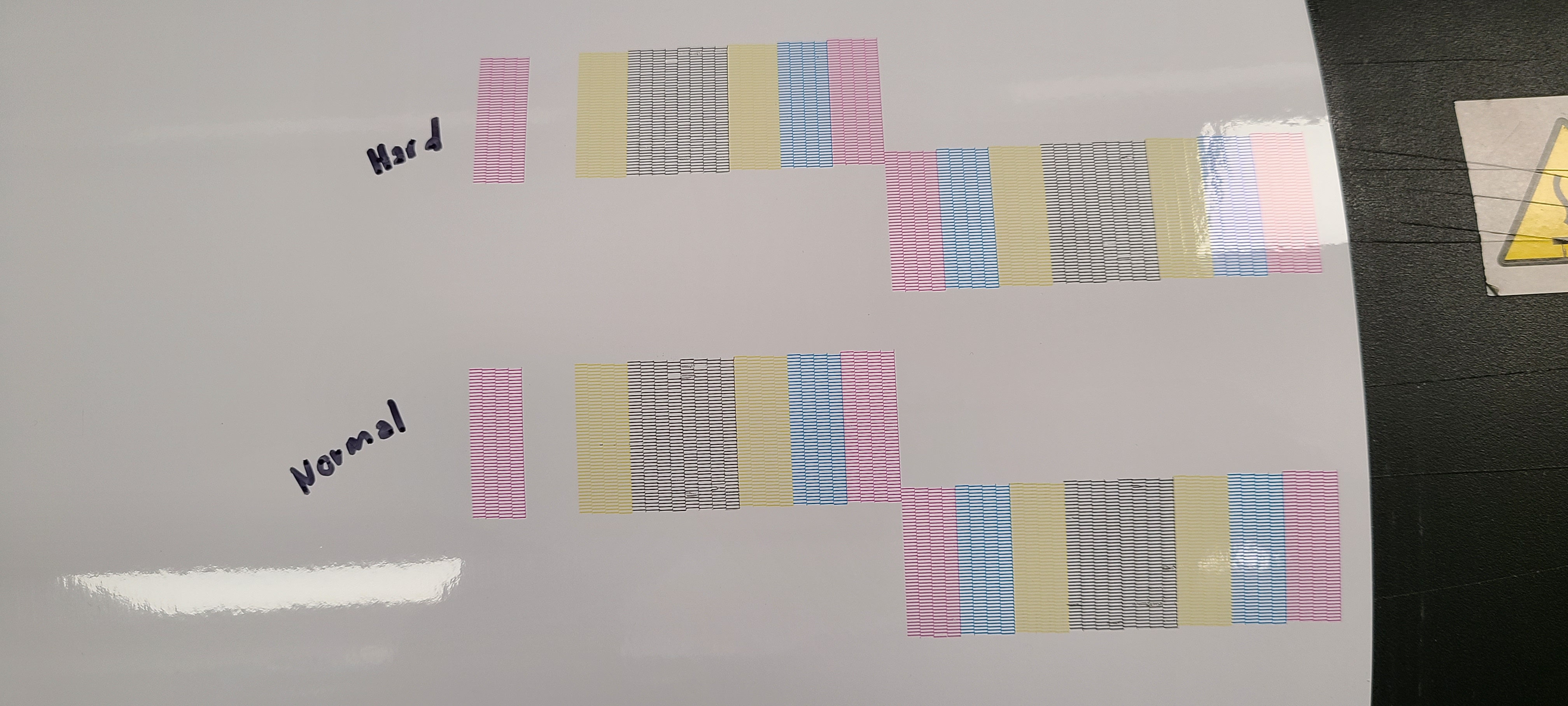

Thanks for the replies you guys and it most likely is the caps&dampeners. There is a tech from the NDgraphics that did some trouble shooting with me and I did an ink fill on normal and hard and it fixed most except for the original Head 1 left nozzles. He said it was likely the dampeners so hopefully the company gets him to come up to service the machine because my previous work experience includes dog grooming and I'm not too sure how to fix an extremely expensive piece of equipment hahah :big laugh:
