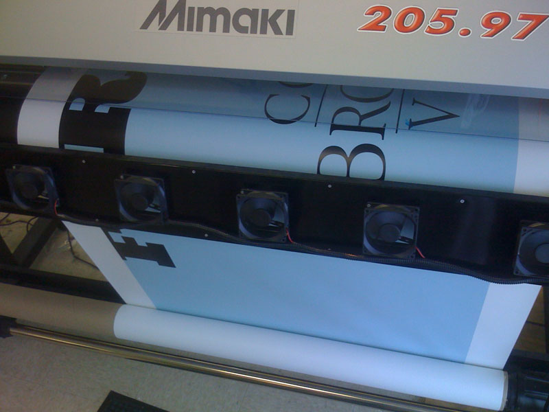

Finally got busy enough to want to print faster and faster. So, we built a dryer using case fans and a power supply from an old computer.
Just tested it out on glossy banner material, 6 pass bi-directional print, solid black swatch, and it was dry by the time it got to the take up roller. YAY!
I thought about using LED fans, but figured they would bug me while looking for color.. so - here it is.
-- as for heat, it sits on the machine right at the level of the post print heater, so it stays pretty warm there. So far, I am able to print 4x faster than before, so I am pretty happy. My wife might be able to see me before it gets dark outside again.
