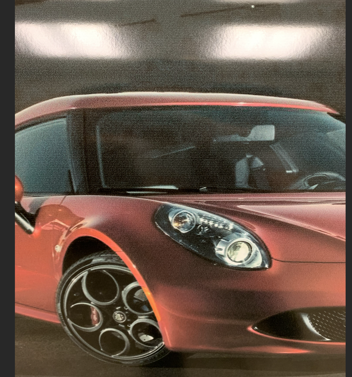

Hello! I am new to this Mimaki printer and I am using Briteline eSeries IM2201. When printing I am getting image quality issues please see the image attach. Just wanted to know if this is normal or if this is wrong and how I can fix this If you look at the print from far away it looks good but close it looks bad. If you look closely at the images you can see the lines that run horizontal. Please any help will be great! I can also provide any other information needed as I am new and don't know what to put. Thanks again.

Your nozzle is clogged, check also media feed

I agree with media comp and also maybe turn up the heat. Looks like the ink sitting on top rather than biting into the vinyl.

You can do a nozzle check but I think it's mostly like feed comp needs adjusting

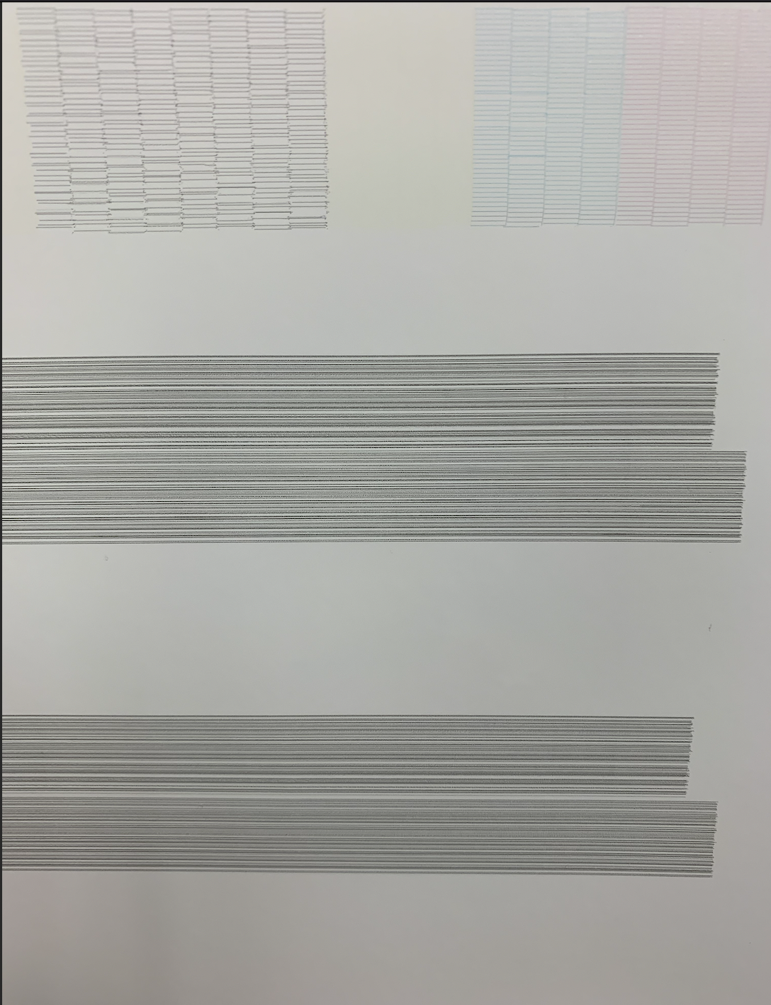

Please see the image below for reference. Also notice the test print. My black always shows up like that no matter how many cleans I do.

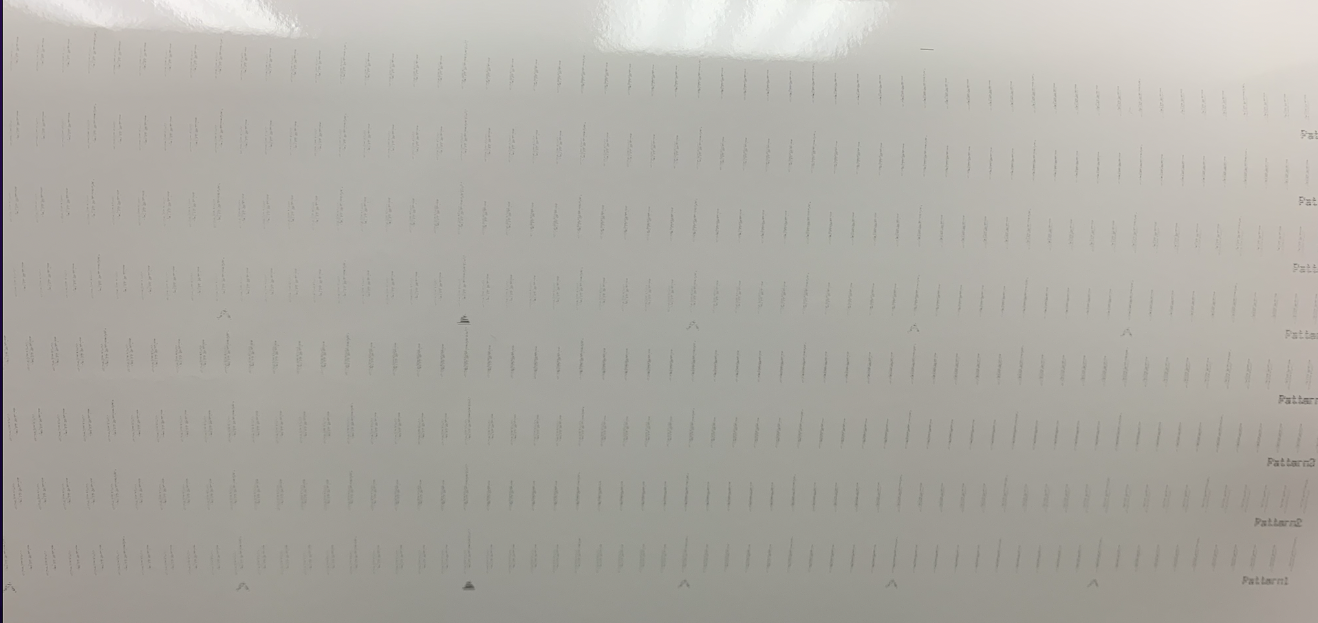

I have also done a drop pattern test and I have tired adjusting the settings but every time I adjust and do another print the line pretty much stay in the same place.
Please see that attached image as well.

The black is causing the problem for sure. You can try doing head soaks and try to manually flush that channel but that looks too far gone to recover unfortunately.
Solventinkjet
DIY Printer Fixing Guide
What would be my next steps to correct the black?
You can try hooking a syringe up to those channels and flushing it with flushing solution but it could cause internal damage that will cook the head for good. It's usually a last ditch effort before getting a new head. If you can't get it to recover with flushing, you'll need a new head.

You also have some cross contamination in the cyan which can be a sign of a bad cap top. You could try that as well. Just in my experience, when the nozzle check looks like that, it's almost never 100% recoverable but you might get it closer to something you can use.
